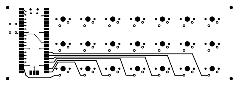

Step 1: PCB
Any PCB designer program will do but I used Fritzing for its simplicity
  1. Before starting on the PCB, make your circuit to know how everything connects (like a planning stage), connecting the key switches with the microcontroller (Raspberry Pi Pico) [image 3].
  2. I made each switch connect to one pin since we have 27 switches and 40 pins [image 2, 3].
  3. After making sure the schematic makes sense, go on the PCB view and start making copper trails to connect each component.
  4. You can find a list of best practices to do when connecting each component to prevent short circuiting and all like this one.
  5. I suggest using FreeRouting to have it all routed for you. All you need are the gerber files of your components and let the program do it for you. Then you can just order it with JLPCB!
  6. The spacing between each switch is 1.75 mm (from their centers).
  7. I used M2.5 holes in the corner of my PCB
  8. You can change this depending on the size of screw you want to use to connect this with the switch plate.
  9. I did M2.5 but I suggest M3 because those screws are easier to find.
  10. Keep track of the spacing between your components to make the later steps easier.
  11. When the PCB is finished, you can now order it! I suggest JLCPCB.com because they are quick and cheap, and you can get 5 boards for $20!
  12. Make sure to check if your files are correct. I sent them a whole folder that your PCB designer program should provide when you export your design.
  13. I printed the etch copper top view of my PCB just in case to check if the layout makes sense (printed something that looks like image 6 and poked the pins of the components to see if the spacing makes sense).
Now you can move on to the next steps while waiting for your PCB to arrive!

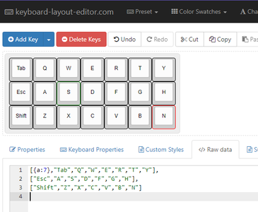

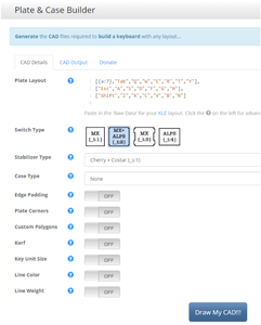

Step 3: Plates
You can either laser cut or 3D print your plates. I suggest laser cutting for a sturdier feel, so you can see the guts of what you made too! (to show how cool your project is!)
  • Your switch plate will depend on your PCB and how you arranged your components. You can see mine in images 2 and 3, I used a keyboard layout editor to get raw data to plug into this plate and case builder website to get an SVG file.
  • I used that SVG file to put into my sketches of the border I had made for my switch plate in Autodesk's Fusion360. Then, I printed it out and got what you can see in image 1, where it's already connected with the rest of the parts besides the top case.
