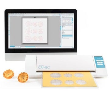

If you have a Silhouette Cameo, you can use that to cut the templates by making use of the Cameo plugin for Pepakura. Found here: https://tamasoft.co.jp/pepakura-en/download/viewer_cut/index.html
Step 2: Print
Print out the templates (link in the introduction) with a printer (duh!) in Pepakura.
If you are using a cutting machine like the Silhouette Cameo you can use Pepakura viewer for Silhouette Cameo to add registration marks.
In the photo I already put my template on a cutting mat for the Silhouette Cameo.
