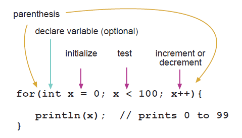

Step 2: For Loops
A FOR loop is used to repeat a block of statements. They will usually implement an increment counter, which is used to terminate the loop, once the desired amount of loops has been executed.
There are three parts to the for loop statement:
For (initialization; condition; increment) {
//The code you want to loop
This is clarified in the image above.
The initialization happens first and only once. Each time the loop executes, the condition is tested. If it is true, the statement block and increment, is executed, then the condition is tested again. When the condition is tested and returns false, the loop ends.
