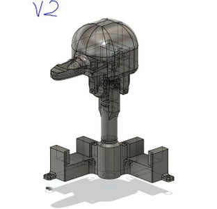

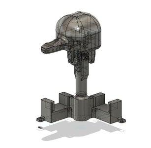

Step 1: Designing the Animatronic
the idea was to design an animatronic, at first i wanted it to move the head front to back side to side and rotate horizontaly
but about halfway though designing it i decided to have a moving mouth as it would make it more lifelike.
my first design was way smaller and more fragile, i also made a huge oversight when modeling, that being that the arm where the servos connect must connect 90 degrees at the same radius above the pivot point otherwise it would lock up when moving in a circle.
looking back on the design process i learned how valuable plannig things out from the start can be, instead of improvising all the way through, as is my usual method.
This project also made me brush up on my arduino programming skills
i now know how to use the servo and pcm libraries
aswell as making memore familiar with fusion360.

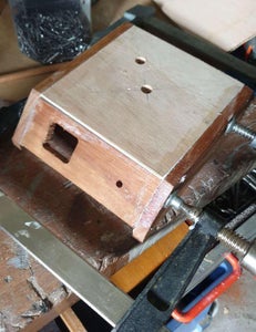

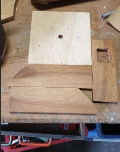

Step 3: Make Wooden Enclosure
instructions for making the enclosure
there are multiple ways to make a box but this is how i did it:
  • cut the wood to the approximate dimensions of the drawing
  • for the part where the joystick goes its important to clear away wood where the pins are gonna go
  • hammer in temporary nails
  • testfit everything so you know everything fits
  • pull apart wood so the nails are possible to place back
  • put glue on the places where it has to stick
  • hammer back down all the temporary nails (this acts as allignent and clamping force
  • clamp down the work piece for extra pressure
  • remove clamps
  • sand down imperfections and finish with a neutral oil or a clear varnish

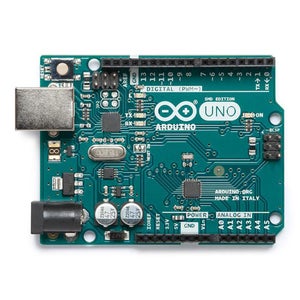

Step 4: Program the Arduino
install FlagPCM library (this is an edited version of the PCM library that avoids conflicts between internal timers) FlagPCM: https://github.com/codemee/FlagPCM
how to install library
  1. download FlagPCM
  2. in Arduino IDE Sketch>Include library>Add .zip library
  3. select FlagPCM
copy the code and upload it to your arduino

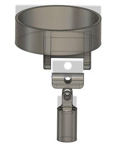

universal joint
  • cut the swivel rod for universal joint ~ 12mm and 17mm
  • push the 12mm part through the middle and top part to the end. then you can route the 17mm part through the hole of the middle and bottom parts of the universal joint
  • glue down one side of the 17mm rod to the side of the bottom part of the universal joint
connection to box
  • route the 10mm diameter rod through the 3d printed parts
  • glue the bottom of the universal joint and the base together onto the 10mm rod
  • screw down the base onto the box

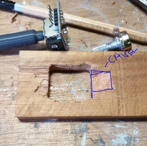

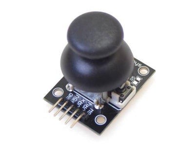

mount the joystick
  • it might be wise to do this after wiring as you likely cant wire it when its firmly in place
  • push the 3d printed plate through the hole cut in the front of the enclosure
  • screw in screws at the back of the joystick
  • push the 3d printed joystick knob onto the joystick component
