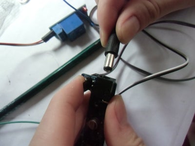

In this step, I need to power the receiver of 315M RF Kit and the relay module (the emitter of 315M RF kit uses on-board 12V battery, do not need extra power), as the they both need 5V, so, I uses a power supply module for breadboard to convert the 9V output from the battery to 5V.
Use the jumper to connect the VCC and 5V on power supply module for breadboard, to make sure the power supply for bread board set to 5V, and connect its output(VCC& GND) to the power supply terminal of relay module and the receiver of 315M RF Kit; and then connect the 9V battery to the DC jack of breadboard power supply module.
