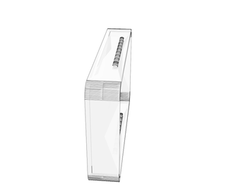

I have owned a few Craftsman Ignition Wrench sets throughout the years. They came with a ‘nice’ vinyl protective bag. These have only lasted a year at most for me as I am constantly opening and closing them at work. They have failed the same way each time, get a hole in the bottom, then the top starts to rip, and finally the plastic latch rips off. So I decided to make a case on my 3D printer

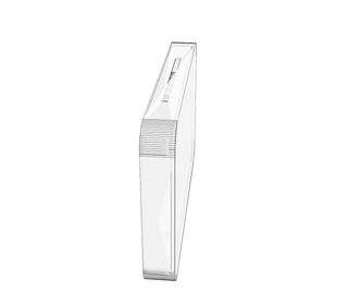

1. How to draw my design in Fusion 360. A basic box is so easy to make in Fusion
360, And there are a couple of ways of doing it. a) sketching out the outlines then padding, b) making a solid then having 360 cut out the interior with your chosen wall thickness. Wow this is great!!!! What used to take a long time in Freecad, took only a few minutes. I was on my way on this one and I figured I would learn how to do the next steps when I needed them.
2. How to separate the top from bottom for printing. I needed to have separate ‘files’ (called bodies in Fusion 360) in order to have a top and a bottom. I found that when I used the ‘combine’ command it has a selection to ‘make a new body’. Second part done.
3. How to add lettering (words) to a surface. This one I was dreading most of all. As with FreeCad it can be laborious to add lettering, position it just so, and then indent it (negative pad?) for printing in one color. To my surprise, Fusion 360 is so….. easy to add text, to any surface! It could almost be called fun.
