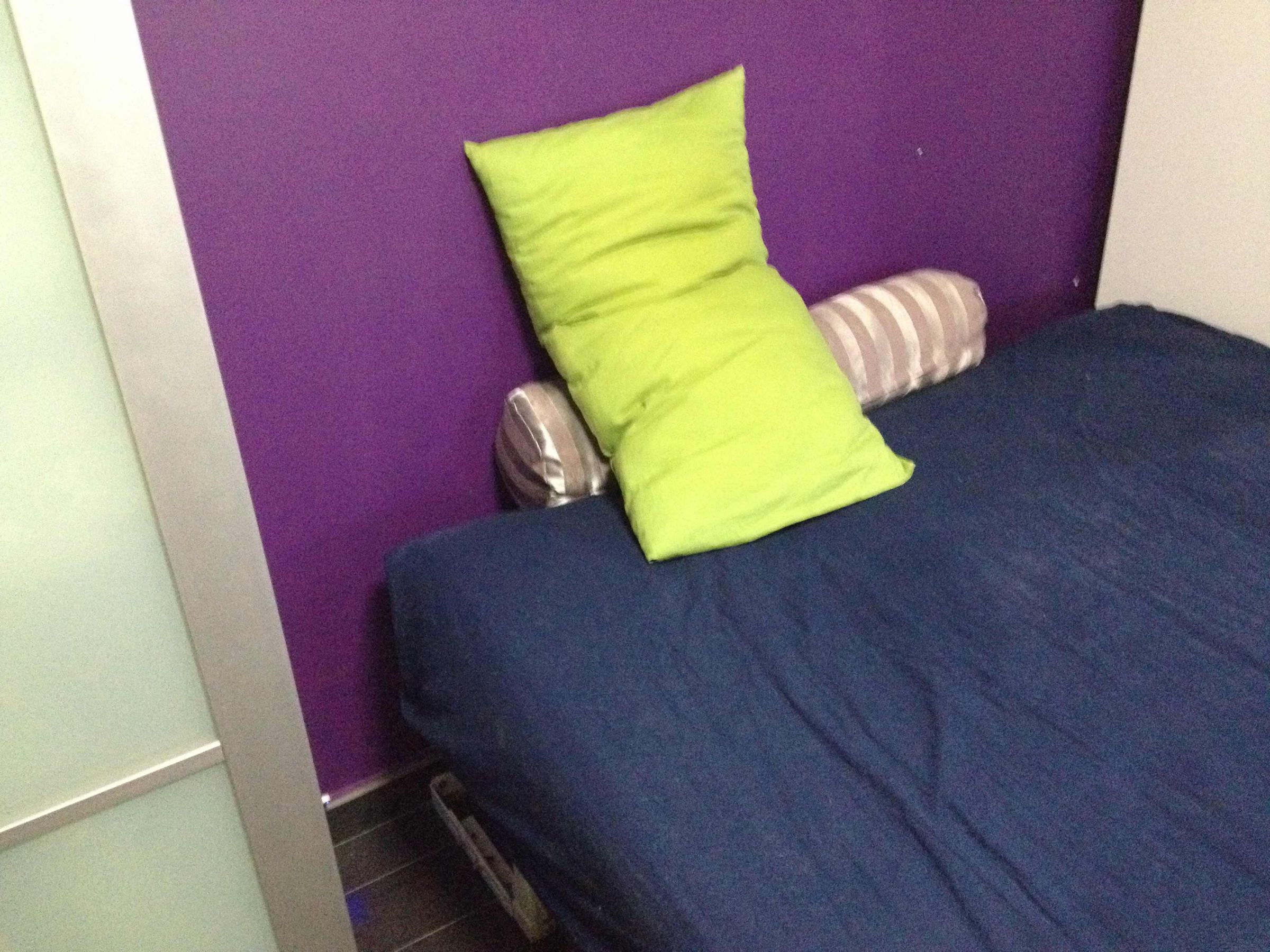

Step 2: Assemble and Install the Bed Mechanism
After some searching online I decided to use the Next Bed kit for the murphy bed hardware.
Here it's shown assembled and installed.  It rests on the floor, and is attached to the wall at the baseboard level with 8 screws.
Just for reference, the mattress is a 12" pillowtop, with a mattresspad on top of that.  It's currently set up so that it's tight to the wall, but there's enough clearance that I move the bed further out from the wall to hang a picture on there.
Overall I'm really impressed with the quality of the Next Bed kit, and would recommend it to anyone. The instructions are clear, and they have several helpful assembly videos available online as well.

    I've just installed the next bed kit too... and I'm still trying to decide how to enclose it in cabinetry, etc... but the most imminent issue right now is that we've realized (too late of course) that there is a HUGE gap between the head of the bed and the wall when the bed is laid down - which of course makes it impossible for guests to sit up and read in bed. Have you figured a way around this? Somehow the picture in your instructable here does not appear to have such a big gap...
    0
    newfangled
    newfangled
    Reply 7 years ago on Introduction
    That huge gap surprised me too, and it's definitely worth mentioning. For a 12" deep mattress you're going to have a 12" between the wall and the bed when it's in the down position.
    I think some of the other mechanisms might be offset back to cut down the gap a bit, but not much. I've seen videos of some of the fancy cabinetry, and they use a headboard that slides up and into position to fix the problem. So I think all murphy bed mechanisms must have this problem to one degree or another.
    Short answer is that my guests don't get to read in bed either.
