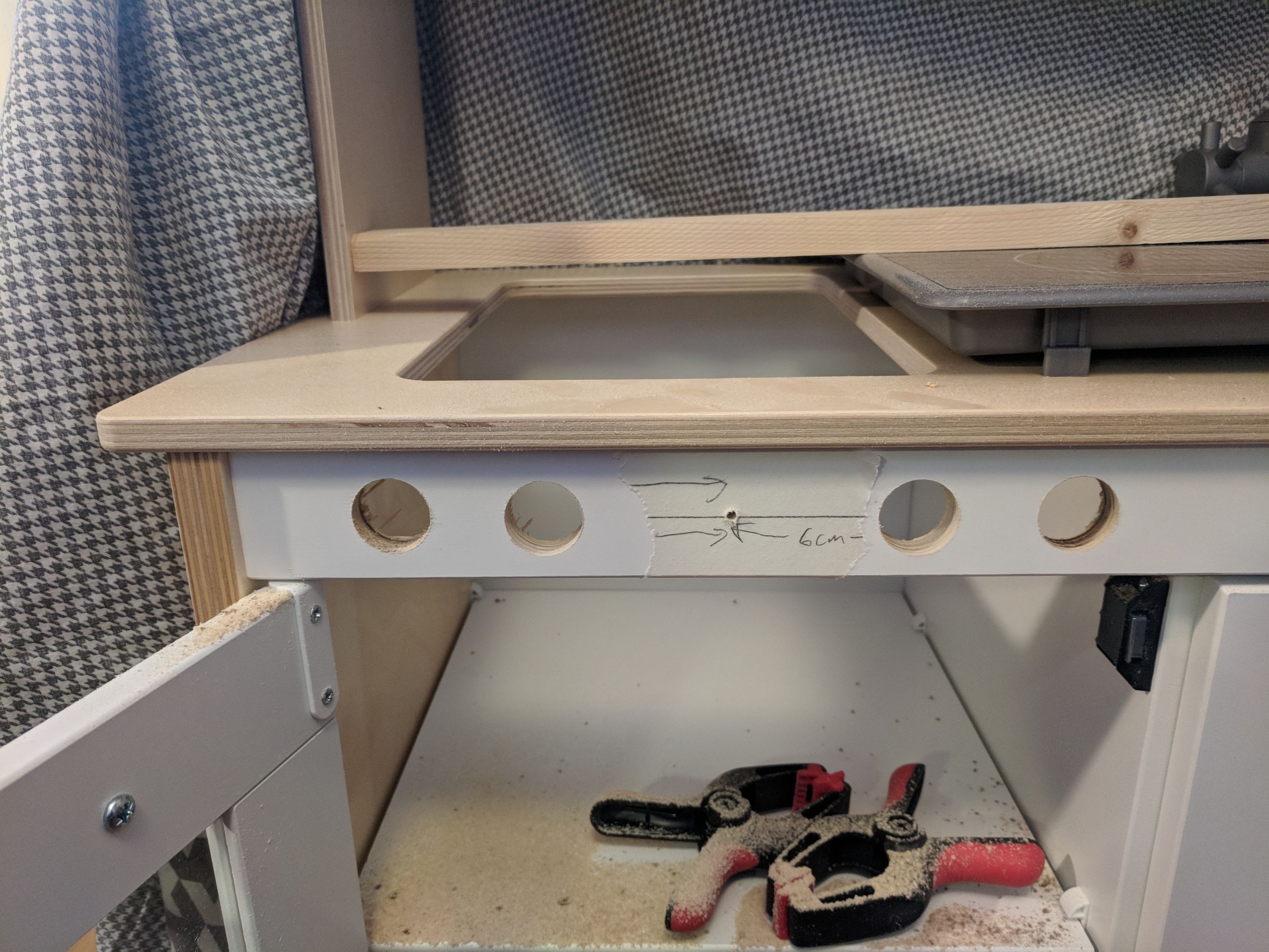

Step 4: The Oven Mod - Drilling the Holes
First thing that we need to do is drill the holes above the oven to house the buttons and the rotary encoder. I did these steps while the kitchen was fully assembled, I just needed to remove the plastic stove top. You may need to remove the door in later steps, but that's easily done.

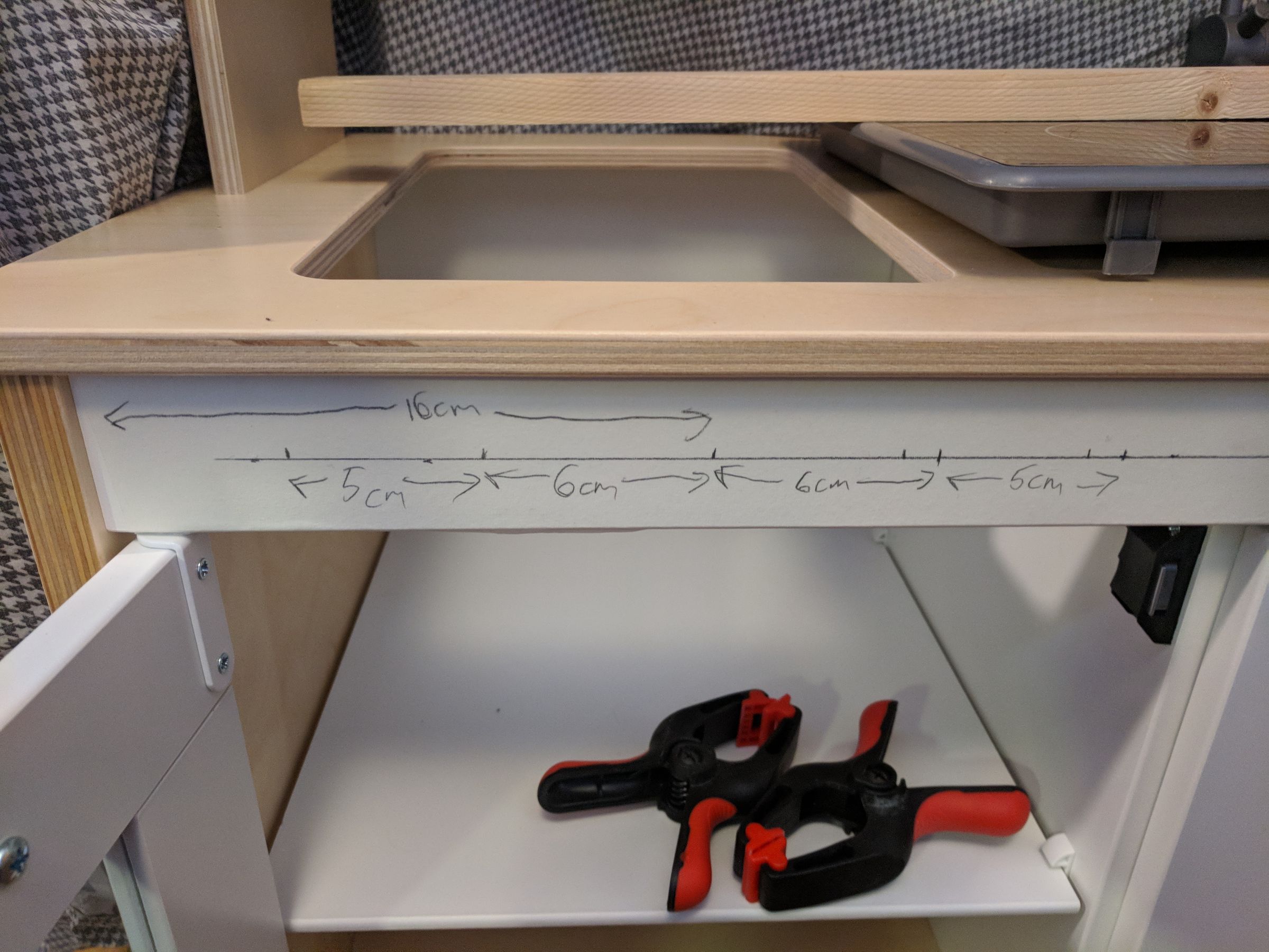

I put some masking tape on the area where the buttons were being places so I could mark out where the holes were and to help protect the finish of the wood when drilling.
I marked out the holes as shown below. The marking for the centre, the rotary encoder, is 16cm from the left. The inner buttons are marked 5cm from the centre and the outer buttons are marked 6cm from the inner buttons.

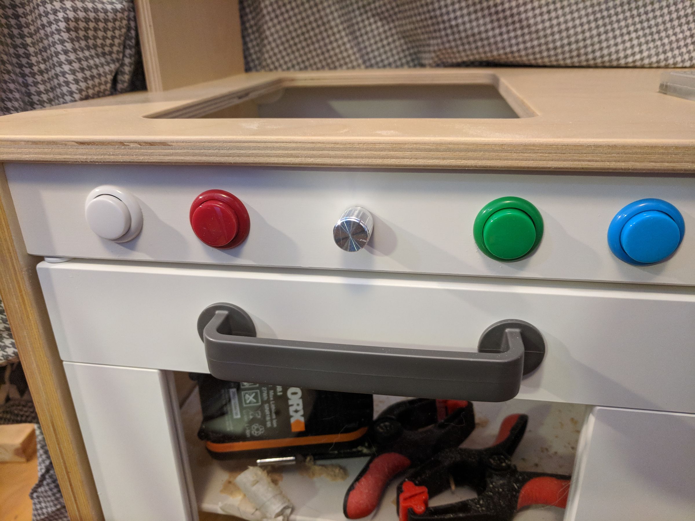

I drilled a guide hole on the markings for the buttons using a 4mm drill bit. I then used a 25mm hole saw to drill the holes out large enough so that buttons could fit in them.

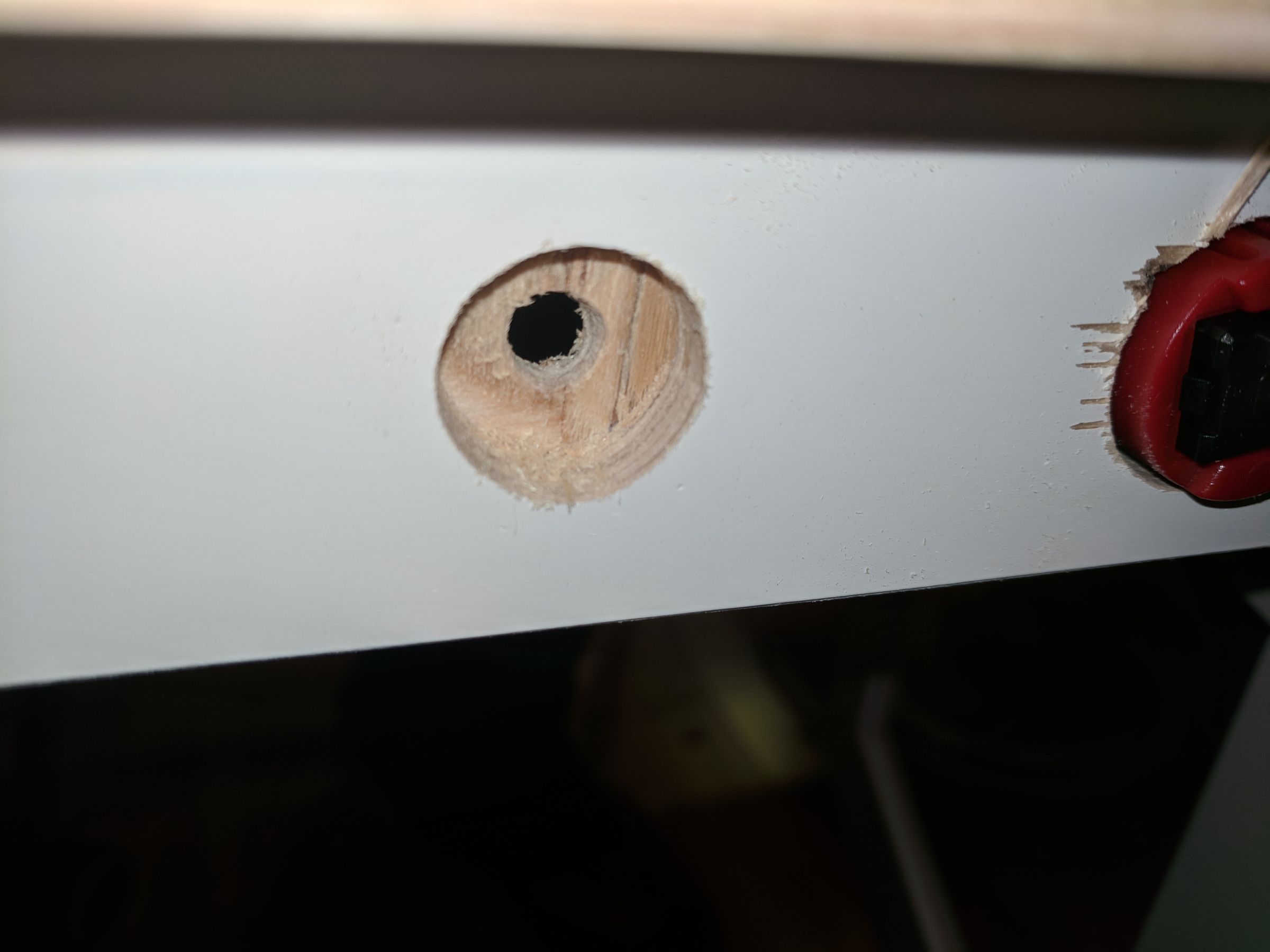

Now comes for the scariest part of the whole build for me, the hole for the rotary encoder. The shaft of my rotary encoder was far to short to be able to just drill a single hole through the wood and get the nut on the shaft. I drilled a hole for the shaft using a 8mm drill bit (I think, please check the size before doing it!). Then from the inside of the oven I used a flat drill bit to drill out a hollow so that the rotary encoder fits inside this to make the depth of the hole the shaft needs to pass through shorter. Be very careful at this part! Take it slow and keep checking if its deep enough for the encoder to go through and grip the nut.

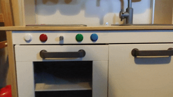

Now would be a good time to test the fit of the button and the Rotary encoder. I was really happy with how they came out!

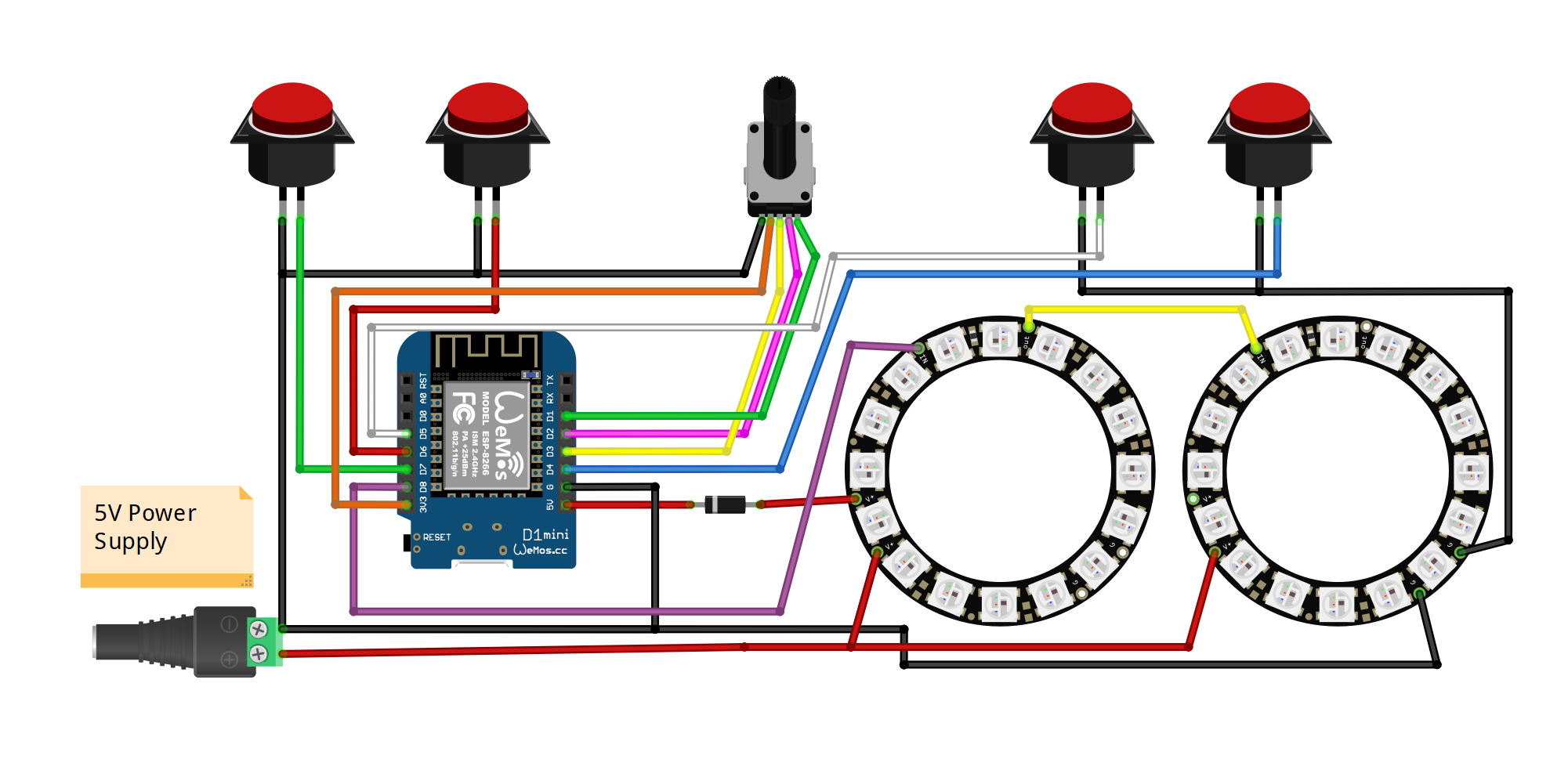

Step 5: The Oven Mod - the Circuit
The main components for the oven mod consists of
- 4 arcade push buttons
- 1 rotary encoder
- 2 neopixel rings
- The D1 Mini ESP8266 board.
The circuit is laid out as follows:

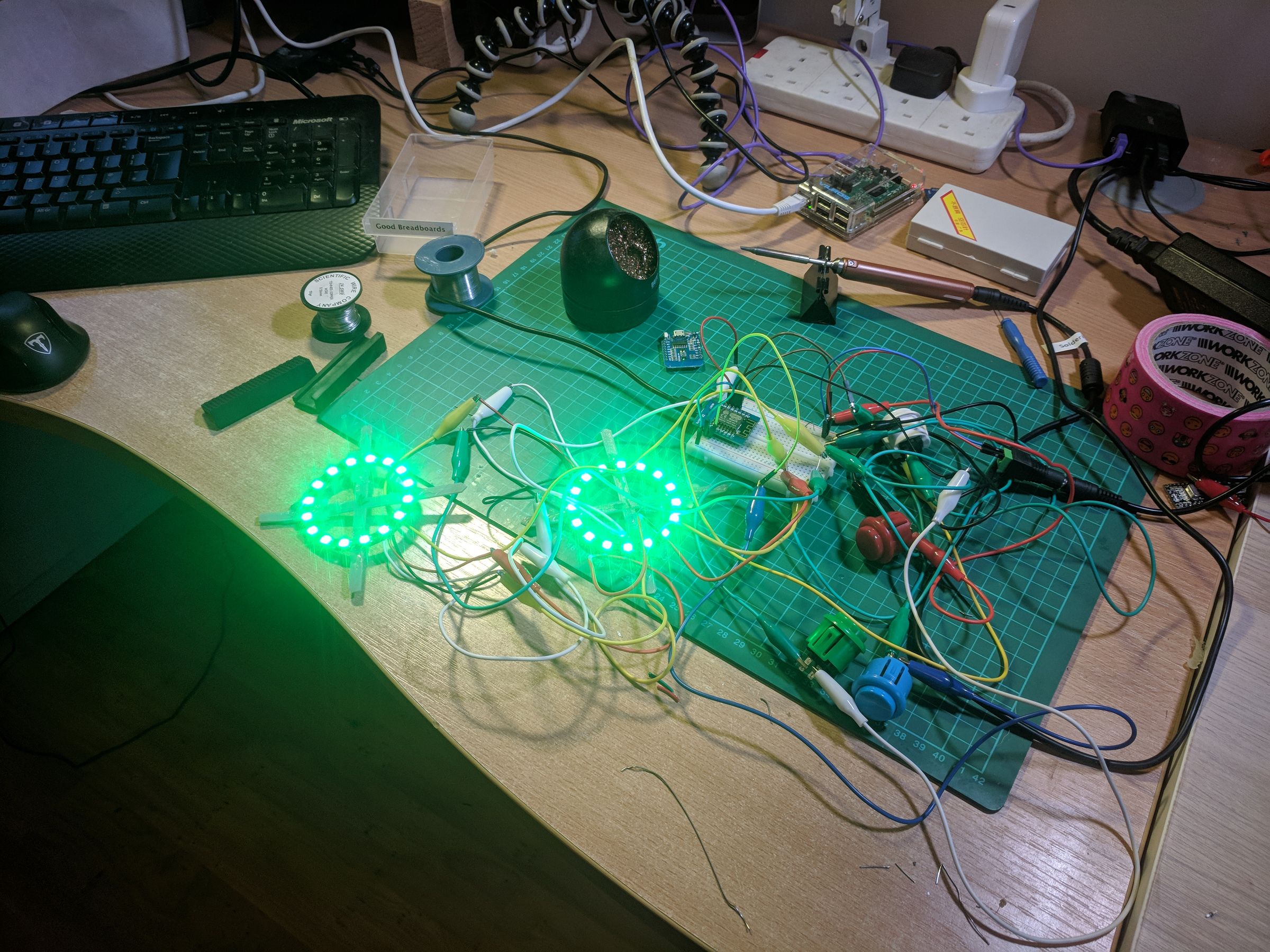

I started by building a proof of concept of the circuit using a breadboard and crocodile clips so I could test out the circuit and start writing the Arduino sketch. It is a bit of a mess but it's a really good way of trialing out what you want to do without having anything permanent.

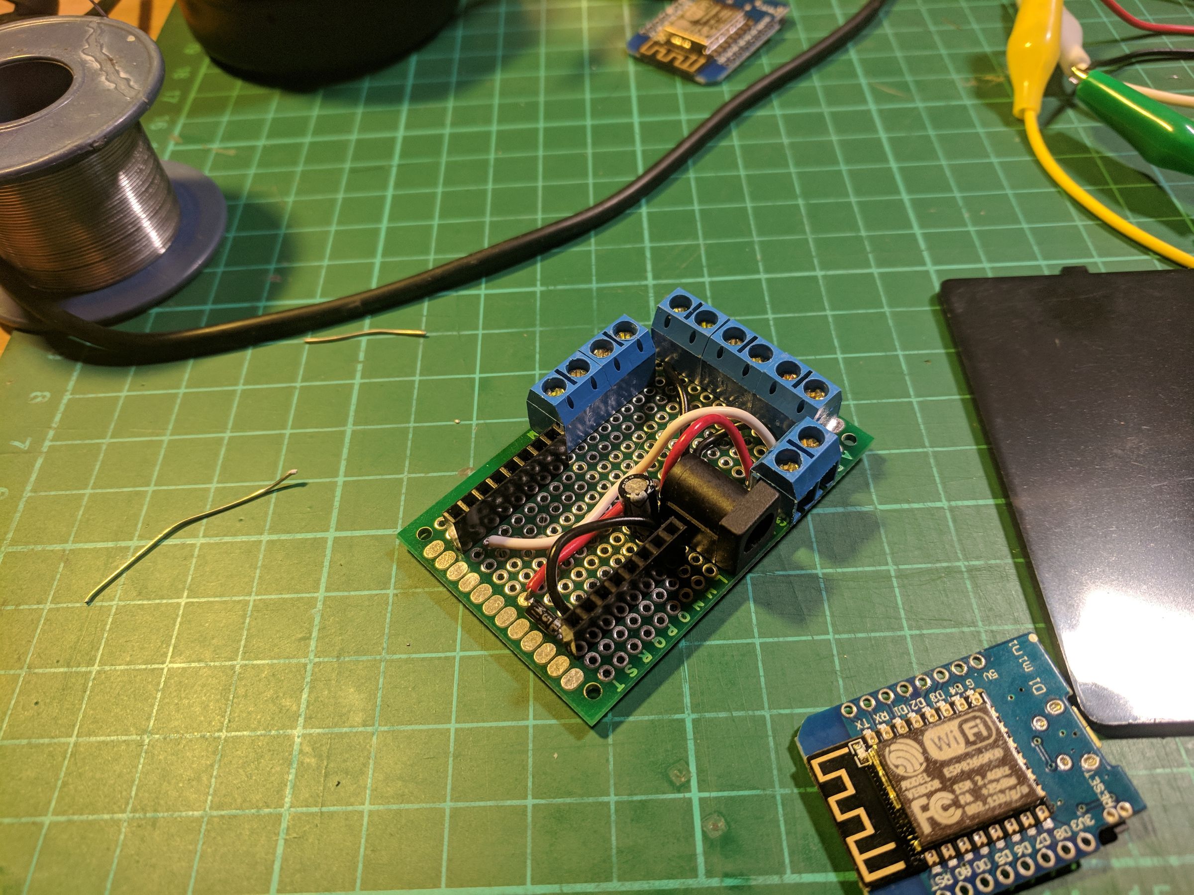

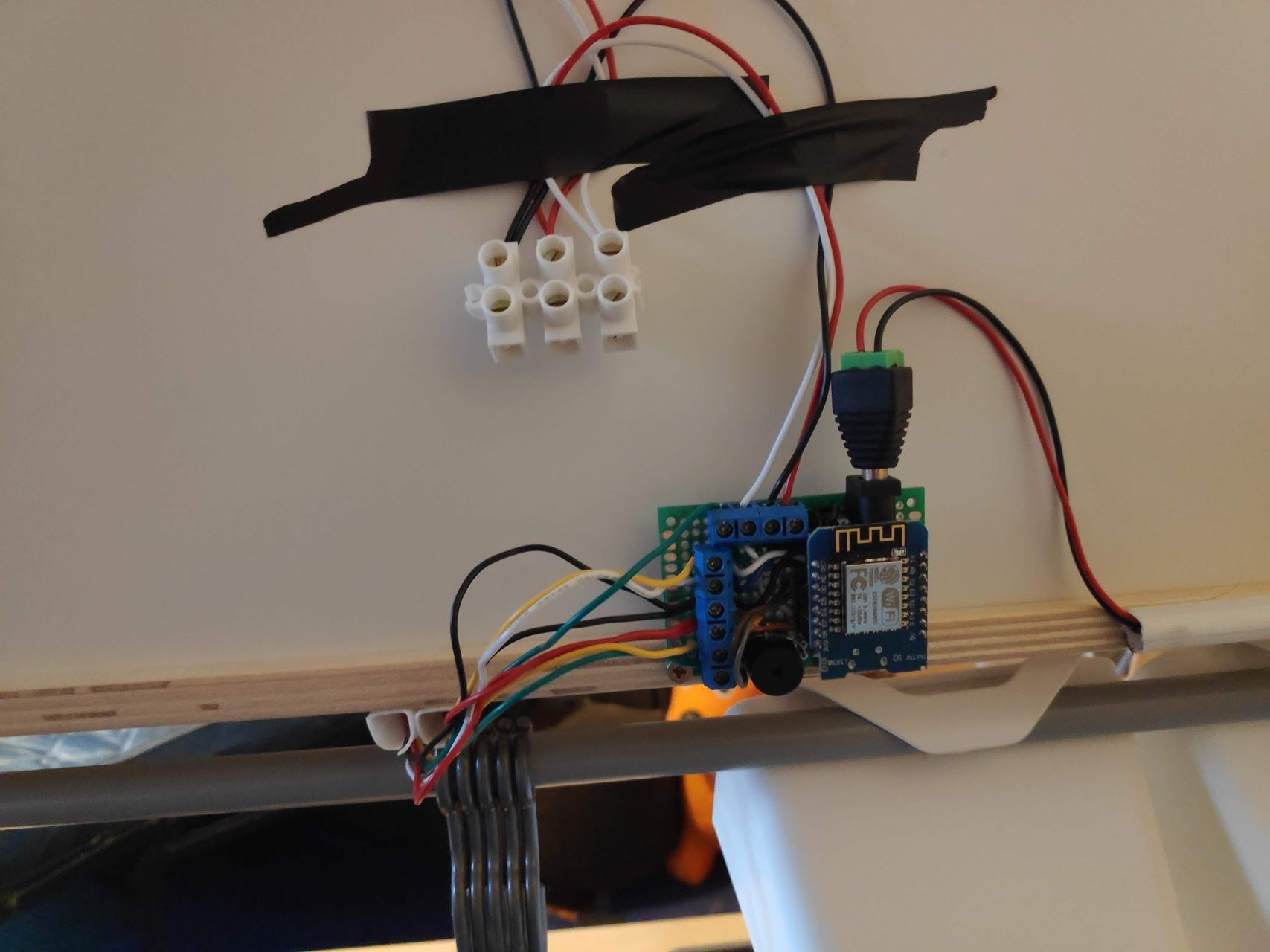

Once I was happy with the POC, I decided to move to a more solid solution. I made up a board using perfboard and screw terminals for connecting all the external components to the board. I find screw terminals are a great way of connecting components that are not attached to the same perfboard as the arduino so it allows you cut the wire to whatever length it needs to be.

I first screwed the perfboard to the inside of the oven towards the back.
For wire I used some CAT5 cable I had to hand. CAT5 has 4 pairs of wires (8 wire in total) so this was perfect to run one length of this up to the buttons. Make sure to keep it long enough to get to the furthest away button while being clipped against the edge (you don't want these wires dangling inside the oven)
My arcade buttons had a hole on their terminals so I decided to just wrap the wire around rather than soldering so I could easily remove if required.

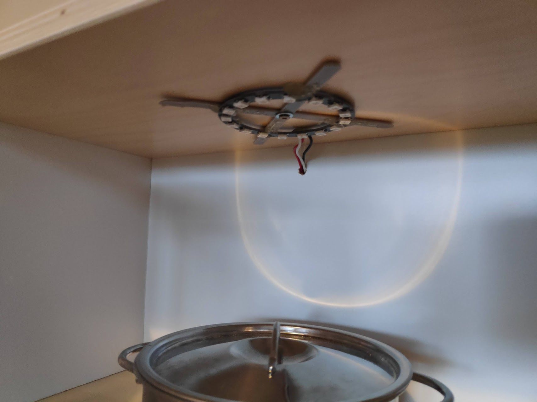

The neopixel rings need to be attached to the bottom of the plastic hob and to the bottom of the shelf inside the oven. I used hot glue to attach these.
I made a makeshift connector for the neopixels rings using male and female headers. This is so the neopxiels rings, or even what they are attached to, could be removed from the kitchen without the need for unscrewing them from the screw terminals. This is especially important for the one attached to the hob as that may need to be removed regular to replace it's batteries etc.

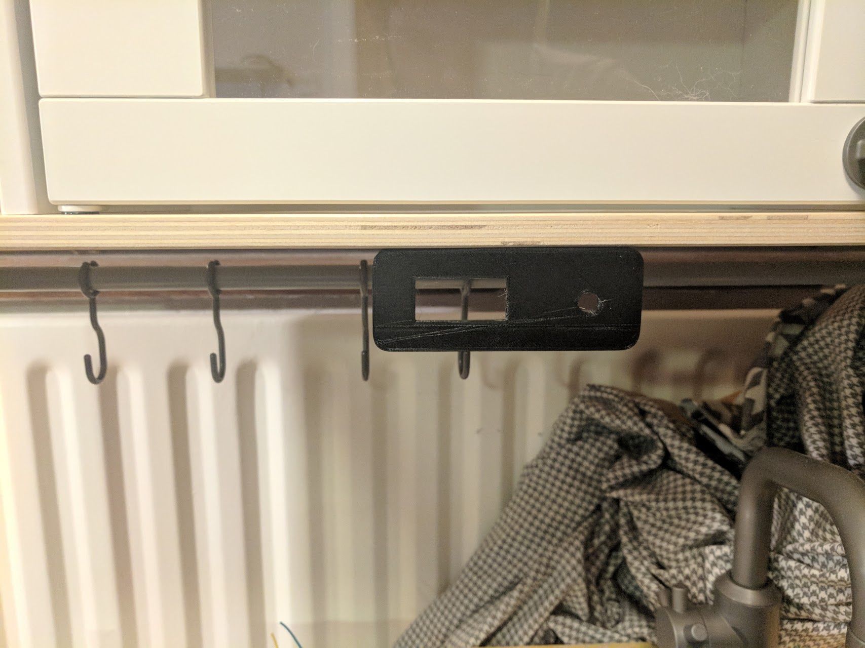

The 7 segment display and the rotary encoder are housed in a 3D printed enclosure that is screwed in below the microwave. This is not an exact fit for the parts (I'm not good at 3D design!) but with a bit of hot glue for the 7-segment display, it does the job fine!
Just to note, that i left the buzzer attached to the perfboard, but if your buzzer is a bit quite it might be a good idea to bring it to this enclosure as well.

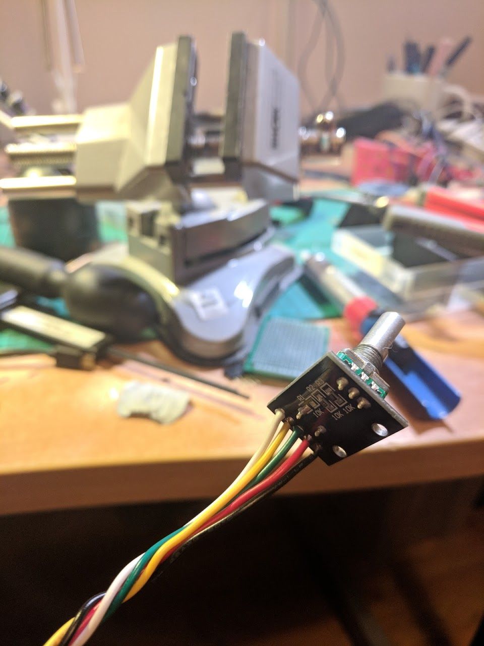

Similar to what we did earlier with the rotary encoder for the oven, we need to replace the pre-soldered header pins with wires for both the rotary encoder and the 7 Segment display.

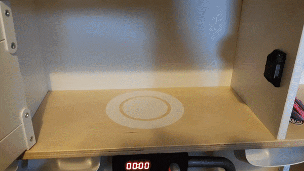

I had too take off the top of the kitchen in order to screw the Neopixel ring into place insider the microwave, but you could just use glue to save yourself this step. I drilled out a hole in the back of the microwave to allow the cables from the neopixel ring out.
I screwed the perfboard to the back of the microwave and connected up all the wires.
