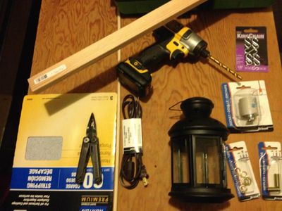

Pictured is essentially most of what you will require for this project. These are the minimum, and as such I have included a list of other tools/supplies which could help you.
Supplies:
Coarse Sand Paper (used 60)
Power cord with rotating switch (or preference)
Lamp socket
Lamp Nipples (heehee)
Locknuts
S hooks
11/16 x 1.5 x 8' Wood (I used Oak)
5/16" Dowel (at least 1.5')
Glue (used Weldbond)
ROTERA ikea lamp (in your choice of color, Black is used here)
Lightbulb
Tools:
Pliers
Drill
5/16" Drill Bit
Saw
Pencil
Schematics (2nd photo)
Staple Gun
Small screwdriver (or knife, lots of things really) [Step 2]
Helpful Tools:
Dremel
-Sanding Bit
-Cutting Bit (For precision/minimal waste)
Sand Blaster OR commercial Glass Froster (Spray)

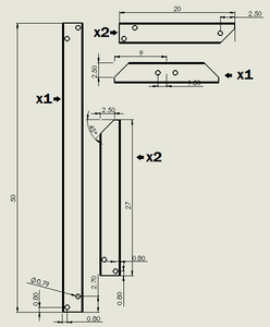

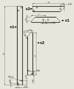

Using the schematics, cut your 1 1/2"x 11/16" wood to size. To recap, you will need
1x 50cm Flat-end Bar (This is the height of your lamp, should you want a longer lamp then cut to size. No guarantee on stability if you go too high though)
2x 28cm bars with one side cut to a 45° angle
2x 21cm bars with one side cut to a 45° angle
1x 20cm bar with both sides cut to a 45° angle
You should be able to utilize the 45° angle cuts to only do them 4 times (one diagonal cut between the two 28cm pieces, one diagonal cut between the two 21cm pieces, and two cuts on each end of the 20cm bar)
Once you have those pieces cut, you can either decide to keep the pointed end or cut them off according to the blueprints (2.5cm from end, 1cm of length cut off). Feel free to sand at this point to smooth out edges that were cut
Also cut the dowel at this point: 7x 5cm/2in lengths (These are slightly over-sized so they can be sanded to flush)

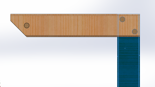

As you can see from my photos, my drilling skills could use improvement. My suggestion is to place mating parts on top of each other to insure the hole drilled will be perfectly aligned. Here is where a drill press will insure precision and a straight hole. For any clarifications, check blueprints for location of holes.
Afterwards, sand holes slightly until the dowel is a tight fit, but still able to get in. If no sanding is required, perfect! however, if dowel is slightly loose that is fine as it can be secured with glue.
Assemble the stand first at the base, using the two longer 45° pieces, the long bar and two pieces of dowel. Once those are secured at a 90° angle, add the stabilizing back piece using another two dowel pieces.
Now assemble the top arm using two dowel to attach the short arms to the long bar, as well as a third dowel at the end. This third dowel will support the lantern.
