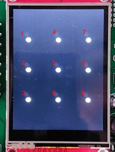

You can easily create your own pattern. Each point on the screen is assigned a number. All you have to do is arrange the numbers in the corresponding order in an array.

Initially, only the dot grid is displayed. Now you can press the screen at any point and then move the pen or finger to the next points. Each detected connection is represented by a white line.
If the pattern matches, a corresponding screen is displayed and an acoustic confirmation tone is emitted.
