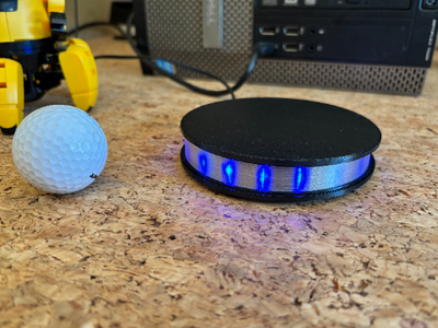

This original idea was to built a visual notifier for an elderly relative with hearing impairment who often misses incoming calls and messages on their iPhone.
The projects makes a bright, ambient light notification lamp with these features:
  1. Large and visible from across the room.
  2. No tiny screens or fiddly apps.
  3. Automatically syncs with their iPhone via Bluetooth.
  4. Glows and animates in different colors depending on the notification type
This gives a simple, reliable way to notice calls and messages that could otherwise be missed!

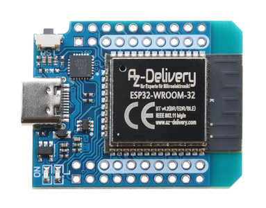

  1. ESP32-WROOM-32 D1 Mini

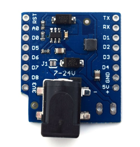

  2. Wemos Mini Power Shield (it does not need to be that specific hardware but this one is cheap and can provide at least 1A on 5V to the LED strip which I believe is a minimum)

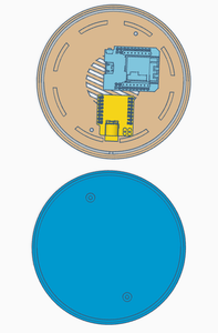

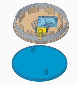

Step 3: Enclosure 3d Print and Assembly
Parts
The 3D print contains of 4 main parts:
  1. Top
  2. Bottom with ventilation

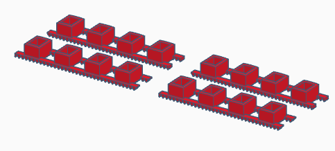

  3. 4 x Light-guides
  4. Diffusor glass with hole for DC jack
Filament
I printed part 1-3 in black PLA and part 4 in transparent PETG. This was what I had in my lab but I believe any combinations of filament will do (as long as the diffusor glass is transparent and lightguide is dark/black)
Lightguide
The reason for having a light-guide is that it separates the LEDs and make it possible to distinguish between what is lit and at what color. Also instead of having a solid ring I printed them as straight segments with a wafer structure which makes it possible to bend them on the inside of the diffusor. This 4 pieces are also easier to sprint on a small printer and due to it flexible design the fitting do not need heating to bend and can be tailored to a larger extent than just a solid piece.
Also if another LED strip type is used say 30LED/m the only thing to re-design and print is the lightguide which takes 30min to print and consumes very little filament.

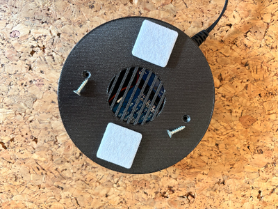

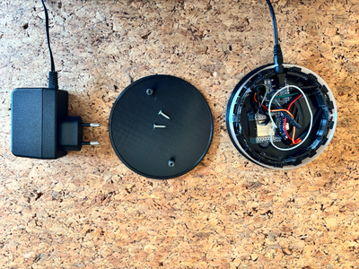

Assembly
Both the Power Shield and the ESP32 is secured with glue to the bottom lid. When gluing the ESP32 put it as far to the side as possible to make it possible to access the USB-mini connector. Let the connector be fitted when you glue to know. Also when gluing the Power shield mount the diffusor glass and DC-adapter to make a proper fit. Make sure the gluing feels solid since over time the DC-jack can be subjected for a lot of wear.
Bottom and lit are fitted together using 2 pcs of 3x12mm screws. Also 2 adhesive furniture pads are fitted on bottom side to improve ventilation since the unit can consume up to 5W.

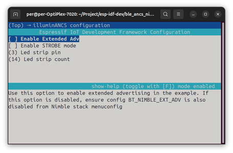

Step 5: NimBLE
Download, structure and build this in the same manner as described in Step 1: Software Environment and Build
Also rename Kconfig_projbuild.txt to Kconfig.projbuild and put in the main folder. This config makes it possible through menuconfig to set:
  1. IO pin number (default is 16)
  2. LED strip length (default is 14)
  3. Strobe or chase mode of animation (default strobe)
Open menuconfig using
idf.py menuconfig
The settings are found under "illuminANCS configuration"
