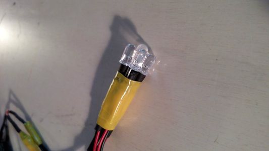

Step 11: Light Source
For my light source, I used 4 white bright LEDs (Max voltage of 3.4, max intensity of 20mA). I used a 9v battery, so I needed resistors to lower the intensity at the LEDs and prevent them from burning out (V=RI). When I figured the resistors I needed (I used 330 ohms total), I wired the circuit and soldered everything together (the LEDs in parallel). Don’t forget heat-shrinking tubes to protect your soldering.
Once the circuit was built, I used a large heat-shrinking tube and electrical tape to connect the optical fiber and light source together.
