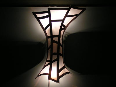

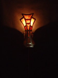

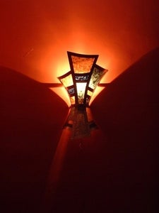

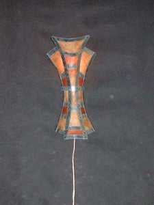

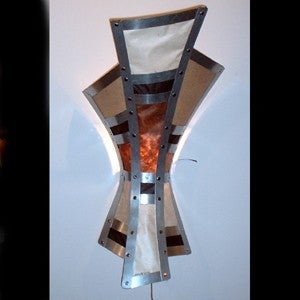

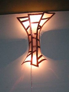

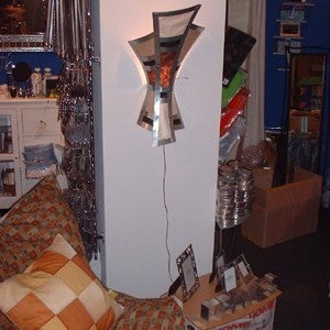

Step 19: Hang and Enjoy
Insert a 7.5 watt night light bulb, Hang and Enjoy.
I have included images of several other variations of the same concept using different materials, including aluminum, copper, galvanized steel for the forms and various papers and high density plastic sheeting for the panels. Use your imagination in creation, my instructions are only meant to be a jumping off point for your work!
