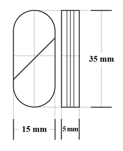

Step 1: Dimensions and Mechanism
One of the challenges in making the locket functional is the size of its mechanism; it needs to be relatively thin compared to its other dimensions. Keeping this in mind, the final dimensions are 35 mm in height, 15 mm in width, and 5 mm in depth.

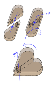

As for the mechanism: Internally, the rotation that allows the locket to transform into a heart is achieved using a press-fitted axle (the pin). Externally, a split axle enables the outer cover to move, revealing the hidden message.

Step 3: Internal Mechanism - First Half
The axle that allows the rotation of the two pieces is press-fitted into the external covers. This axle is a small pin. The half of the pin with the head is inserted without adhesive, while the other half is bent and secured with instant glue. I recommend making some preliminary marks to ease the process with sandpaper and a rotary tool.
Step 4: Internal Mechanism - Rotation Axle
Once the first part is glued, the head of the pin is press-fitted with the internal covers, which are adhered together without the glue touching the pin; otherwise, the rotation will be hindered.

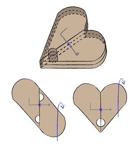

Step 5: External Mechanism - Sanding and Marking
The external covers must be sanded down to a thickness of 1mm. Then, aligning with the semicircles on the internal covers, the half-axles are positioned.
Step 6: External Mechanism - Assembly
The half-axles are gluedto each half of the external covers, and finally, they are assembled into the complete mechanism.
