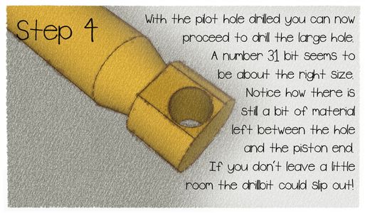

Step 4: Full Sized Tinder Hole
With the pilot hole drilled you can now proceed to drill the large hole. A number 31 bit seems to be about the right size. Notice how there is still a bit of material left between the hole and the piston end. If you don't leave a little room the drillbit could slip out!
