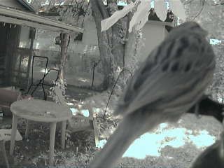

After you have successfully streamed data to the serial terminal copy, paste the data into a text file. Now all you have to do is write the data to a binary file. You can't give your file an extension of .jpeg. My friend Ron wrote a python script, which I have included, that takes advantage of python's "struck" module. This script reads in a text file of hex values and writes to a JPEG file.
The LinkSprite camera has a resolution of 160x120; I've included an example image to give you an idea of the quality/size.
You will, most likely, have some errors in your photo. If you don't, that's great! If you do, please read the next step!
