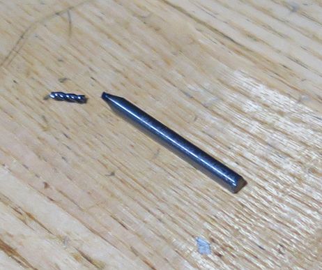

I used the software ArtCAM to generate the relief based on the mapped image, and to generate CAM. I used a profile path to create a trough around the image. After a roughing pass with a 1/2" end mill, I did consecutive finishing passes using 1/4", 1/8", and finally a 1/16" ball mill. Do not turn off the coolant with this bit! Even though there was a pool of coolant, I still broke a bit due to overheating.
