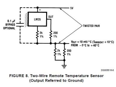

Step 4: Temperature Sensor Sub-Assembly
The temperature sensor sub-assembly uses the LM35 temperature sensor, some resistors, and wire. This sensor requires a circuit to provide the proper signals. This circuit is detailed in the attached drawings:
First measure the connection wires that will be used for the sensor. The sensor will sit on the floor of the Immersion Cooker on the opposite end from the heating elements. I did this to ensure that I was getting a temperature reading for all of the water, not just the water immediately surrounding the heating elements. You need three strands of wire long enough to traverse the floor and wall of the tub plus another three feet to reach to the control box. I used different wire colors as you will have a ground, 5 volt, and sensing wire.
Start by soldering an extension signal wired to the +VS terminal of the sensor. Next solder a 200⦠resistor to the central (Vout) terminal. Then solder a 2K⦠resistor to the Gnd terminal of the sensor. My local RadioShack™ did not have 200⦠or 2K⦠resistors so I used 220⦠and 2.2K⦠resistors. Next I twisted the loose ends of the resistors together. I then took a 220⦠and 2.2K⦠resistor and twisted their ends together on both ends, essentially placing them in parallel as in Figure 8 above. Add a signal wire and twist one end of the parallel resistors to the twisted ends of the resistors coming off of the LM35 sensor. Apply solder to this connection. Finally, solder a ground wire to the remaining twisted end of the parallel resistors.
Next braid the wire strands so that you’ll be able to easily route the wire and sensor through the tubing that will become the water-tight temperature sensor channel on the bottom of the cooker.
Next construct water-tight the temperature sensor channel. First, use the hot glue gun to glue the nylon screw into the nylon tubing. Then glue the tubing along the center of the floor, and up the side of the tub.
You should be able to easliy thread your temperature sensor into the water-tight channel as depicted in the above photos. Trim the water tight channel at the upper edge of the tub.

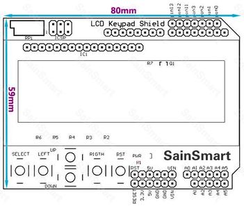

Plug the SainSmart LCD/Keypad shield into the Arduino Uno making sure that all pins are properly engaged. Connect the Arduino to your computer by USB serial port and compile and download the attached code into the device. If you would like the device to default to Celsius operation, simply change the variable "iTempMode" from "FARENHEIT" to "CELSIUS" before you compile. Note that it is possible to change between farenheit and celsius operation on-the-fly (see step 10).
Use the small screw in the top-left corner of the SainSmart LCD/Keypad shield to adjust the brightness of the display as necessary. Unplug the Arduino, shutting it down. Remove the Arduino Uno from the SainSmart LCD/Keypad shield.

int GetCurrentTemp()
/* Module: GetCurrentTemp */
/* Version: 1.0 */
/* Version Date: 05/01/2012 */
/* Author: Edward A Ranzenbach */
/* Description: */
/* This module reads the current temp from the */
/* sensor and stores it to the signal smoothing */
/* array. The temperature from the sensor is in */
/* Celsius and we convert to Farenheit as required */
/* by the current operating mode. The user is then */
/* returned an interger representing the smoothed */
/* (i.e. average of all temps in the array) */
/* temperature. */
/* History: */
/* 2012-05-01 - Edward A Ranzenbach */
/* Initial coding */
int iReturnTemp = 0;
float fCumulativeTemp = 0;
float fADCIn;
if ((iCurrentIndex) == TEMP_COUNT) // stay within array bounds...
iCurrentIndex = 0;
fADCIn = analogRead(TEMP_PORT); // get temp signal from sensor…
if (iTempMode == CELSIUS) // do conversion to Celsius…
fTemp[iCurrentIndex] = (((fADCIn * 3.7) / 1024) * 100);
else
fTemp[iCurrentIndex] = fADCIn; // straight reading is in farenheit…
for (int iIndex = 0; iIndex < TEMP_COUNT; iIndex++) // sum the last X readings...
fCumulativeTemp += fTemp[iIndex];
iReturnTemp = ((int)(fCumulativeTemp / TEMP_COUNT)); // return smoothed temp...
iCurrentIndex++; // bump index for next call...
return(iReturnTemp);

int ReadKeypad()
/* Module: ReadKeypad */
/* Version: 1.0 */
/* Description: */
/* Reads the SainSmart keypad. If the user */
/* depresses a key, a value is returned. That value */
/* may vary from device to device. Thus, we */
/* determine the value by seeing if we are close to */
/* the read value. */
/* History: */
int iKeyIn = analogRead(KEYBOARD_PORT);
if (iKeyIn > 1000) // this will be the most often result...
return btnNONE;
else if (iKeyIn < 50)
delay(KEY_BOUNCE_DELAY); // handle key bounce...
return btnRIGHT;
else if (iKeyIn < 195)
return btnUP;
else if (iKeyIn < 380)
return btnDOWN;
else if (iKeyIn < 555)
return btnLEFT;
else if (iKeyIn < 790)
return btnSELECT;
else return btnNONE; // if all else fails...

fTemp[iIndex] = ((fTemp[iIndex] * 3.3) / 1023); // 10 millivolts per degree Celsius
