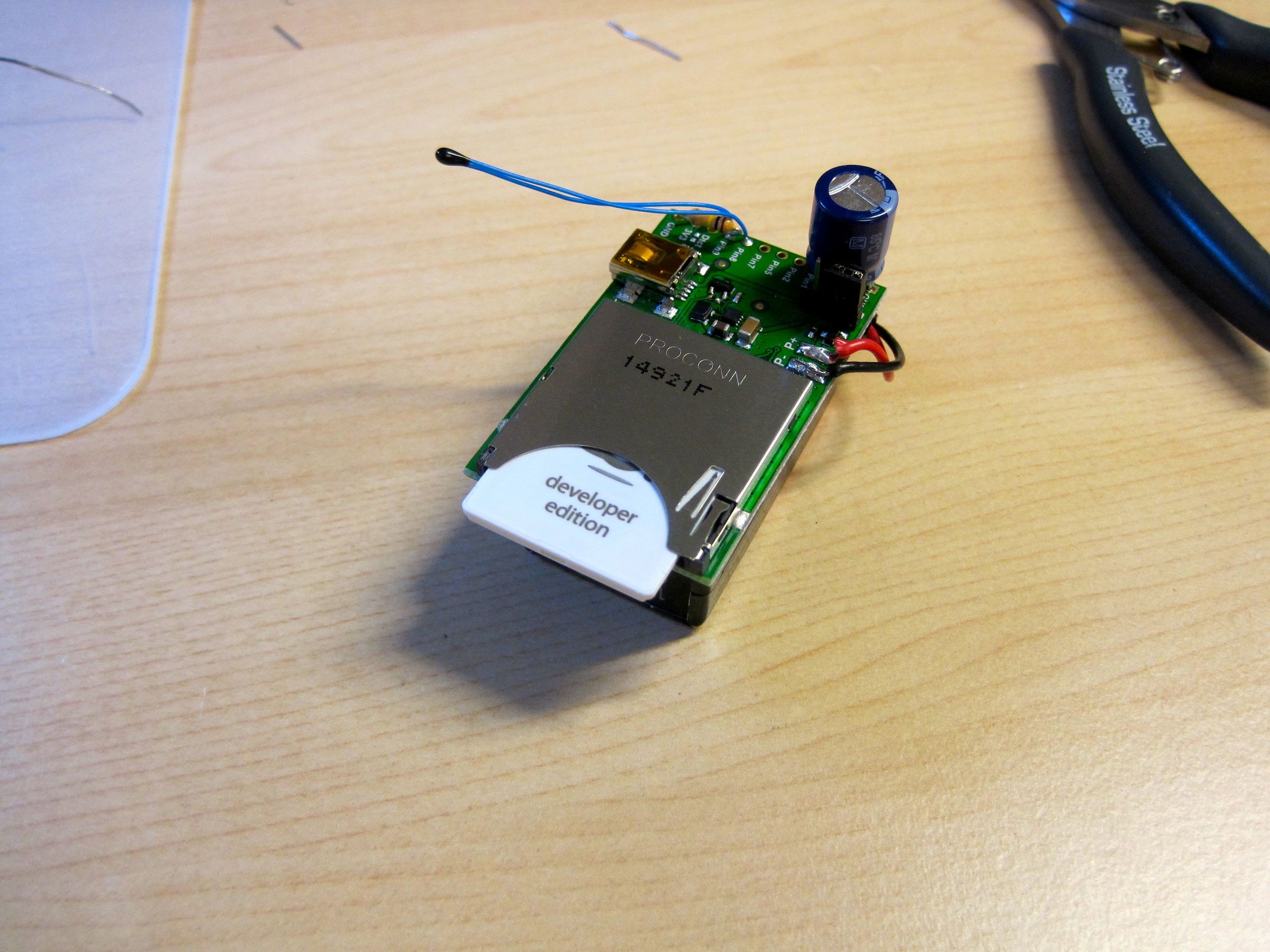

Step 2: Wire It Up
Here's how we'll wire this device up:
- Connect the button. This button is going to serve as an on/off button for your device. The firmware included automatically sends the device off to sleep after a period of inactivity. This button will be used to wake the device up, or to force it to sleep immediately to save battery. The button will set the imp's Pin1 high when pressed, which can be used to wake the imp from deep sleep.
- Line the button up so the little feet are pointing toward the shorter ends of your breakout board, and line the bottom-left foot up with the Pin1 pad on the imp breakout board. This will line another of the button's feet up with Pin5 on the imp breakout board Tape the button in place, then heat the pad and the button's foot with your soldering iron and apply a little solder. Solder the other foot to Pin5 the same way. Pin5 isn't used for anything in this device, so this is just a good way to make your button more mechanically sturdy.
- Cut a short piece of wire, strip both ends, and point-to-point solder the other end to one of the two feet on the far side of the button. Tape the wire in place so it is touching the foot of the button, then heat both the wire and the foot with the iron. Flow a little solder onto the heated parts.
- Solder the other end of the wire to the 3V3 pad on the breakout board. You may want to wait to apply the solder to this terminal, because we need to wire another wire to this pad.
- Solder leads to your sub-mini audio jack. This jack is where you'll plug your temperature probe in. Because the temperature probe doesn't have any polarity, it doesn't matter which way around the jack is connected.
- If you're using a switched jack, like I did, there will be a third terminal; this is a switch terminal, and is used to detect when there is a plug plugged into the jack. You don't want to use this, so make sure you're using only the terminals that are supposed to connect to the tip and the shield of the plug. If you're not sure which you've got, you can use a multimeter to check for continuity. If you do this, make sure you install a plug in the jack before testing, because otherwise the tip contact and switch contact will be electrically connected.
- Cut and strip two medium (3") pieces of wire. Run one end through each of the terminals you wish to connect. It's very helpful to tape the jack and the wire down to your work surface at this point to hold them steady.
- Heat the terminal and wire with the soldering iron, then flow some solder onto the parts. Make sure you heat the wire as well as the terminal, or the solder joint will break.
- Connect the jack between 3V3 and Pin9 on the breakout board. Don't solder the Pin9 pad yet; we still need to attach a resistor to that pad.
- Run the free end of the wire from the jack through the appropriate terminal on your breakout board, then heat the wire and pad with the iron and apply some solder.
- Make sure both the wire from the jack and the wire from the button are through the 3V3 pad before soldering.
- Connect the 47kΩ resistor between Pin9 and Pin8.
- The Pin9 pad on the breakout should still be unsoldered. Make sure both the jack and one side of the resistor are through the pad, then solder both in place.
- The other side of the resistor should be soldered to the Pin8 pad on the breakout. You can go ahead and solder it right away; we don't need to connect anything else to this pin.
- Connect the battery holder. Apply a small square of double-sided foam tape to the bottom of your breakout board and remove the backing on the other side. Apply the battery clip here, so that the battery will sit nicely along the bottom of the breakout board. Hold the battery clip and breakout board together for 10s.
- Connect the battery contact. If the ends of the wires on your battery contact did not come pre-stripped, strip the ends. The positive side (red) goes to the "P+" pad on the breakout board, and the negative side (black) goes to "P-". Note that the P+ and P- pads are surface-mount pads, along the side of the breakout board, not through-hole pads along the end of the board like the other contacts. For each wire:
- Tape the wire in place.
- Heat the wire and pad together with the soldering iron.
- Flow a bead of solder over the wire and pad together.
