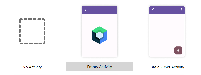

Step 1: Starting the Project
Since it will be an Android App -- ACalculatorApp -- naturally, we will create an Android Studio project for it. Moreover, inside the project, we will be creating a little Rust project for developing the JavaScript "bridge".
Simply, create an Android Studio project ACalculatorApp

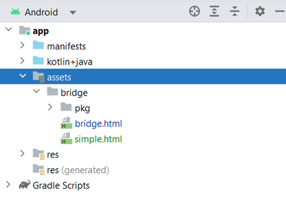

Step 5: Package the "Bridge" With the App
It is possible to package the "bridge" in the app's PKG. To do so, we will need to put everything of the "bridge" to the assets folder like the screenshot above.
To copy the "bridge" over to assets, after building it by running
wasm-pack build --target web
additionally run
mkdir ../app/src/main/assets
mkdir ../app/src/main/assets/bridge
cp bridge.html simple.html ../app/src/main/assets/bridge/
cp -r pkg ../app/src/main/assets/bridge/pkg
In order to make things easier, create a rust/build.sh like
set -ex
cp *.html ../app/src/main/assets/bridge/
Now, every time want to build the "bridge", in rust run build.sh

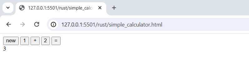

And we use another "bridge" -- simple_calculator.html
<script type="module">
import init, { Calculator } from './pkg/dumb_calculator.js';
async function load() {
await init();
window.Calculator = Calculator;
load();
</script>
<script>
function new_calc() {
calc = Calculator.new(5);
_sync_calc();
function _sync_calc() {
let display = calc.get_display();
let elem = document.getElementById('msg');
elem.innerText = display;
</script>
<div id="buttons">
<button onclick="new_calc()">new</button>
<button onclick="calc.push('1'); _sync_calc();">1</button>
<button onclick="calc.push('+'); _sync_calc();">+</button>
<button onclick="calc.push('2'); _sync_calc();">2</button>
<button onclick="calc.push('='); _sync_calc();">=</button>

Notice that in another <script> block, some JavaScript functions are defined
- new_calc() should be called to crate a new Calculator instance, and assign it to the JavaScript variable calc
- after creating a new Calculator instance with new_calc(), can call the methods of Calculator like calc.push('1')
- _sync_calc() is there to synchronize the Calcuator's display with the "msg" <div>
(above screenshot)
Try it! Simply change the above simple.html to simple_calculator.html, like in ENDPOINT
