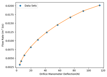

Step 1: (Linear) Flow Rate As a Function of the Orifice-plate Meter
The line of best fit is the calibration curve.

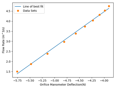

Step 2: (Logarithmic) Flow Rate As a Function of the Orifice-plate Meter
Alternate calibration, data appears to be a straight line, meaning a power law can be applied.

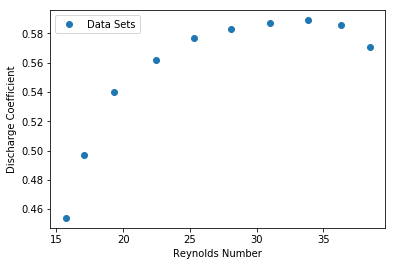

Step 3: Reynolds Graph, Linear Scale

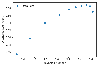

Step 4: Reynolds Graph, Logarithmic Scale

Is the discharge coefficient Cd essentially constant over the range of Reynolds numbers tested? Are the experimentally measured values for Cd close to the ideal value of unity derived theoretically? What corrections might need to be made to the theory to obtain more realistic values for Cd?
- The Reynolds number is proportional to velocity and velocity is proportional is to flow rate. If the velocity increases then so will the discharge coefficient. Therefore the coefficient is not constant with the Reynolds number. The discharge coefficient only reaches to about .6, the error is caused by assuming inviscid flow.
