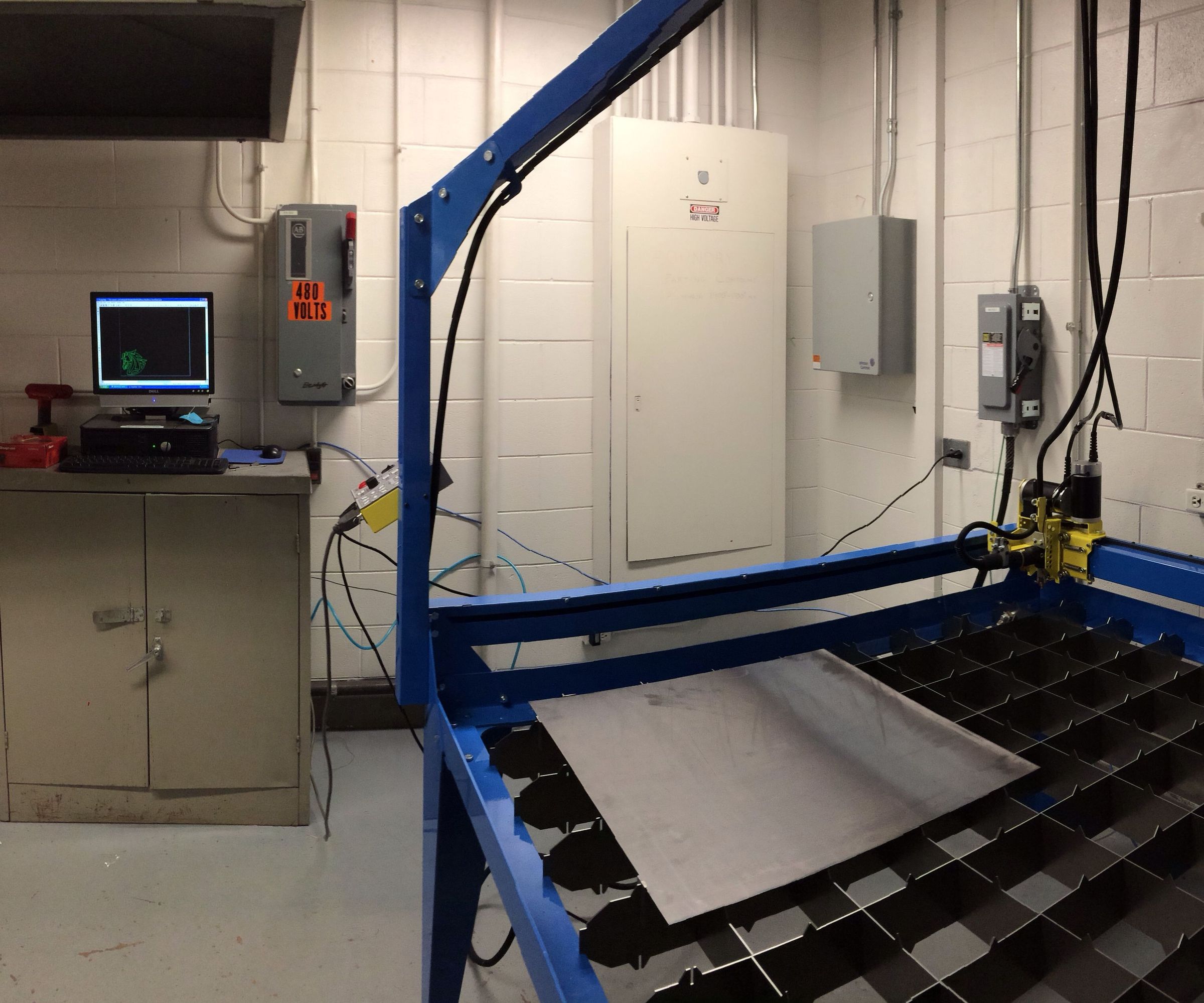

Introduction: Importing JPEG Into DesignEdge
This is how you import a JPEG image file into the Design edge software to be cut with the CNC plasma cutter. More skills are outlined in my other instructable (Using A CNC Plasma Cutter).

The piece of metal that will be used to cut is 24in x 24in. Therefore i will be making a box 24x24 in the program. I did this just as an easy reference point so i know the design is not bigger than the metal i wish to cut. After the box is drawn you can use the move and scale commands to make the drawing fit.
Step 6: Convert to Cut Path
When converting to cut paths you must think about what should be cut first so it does not fall through the table. Under the 'machine' tab select 'covert to cut path', now you will select in order the lines you wish to cut. Note that when converting to cut paths you see an extra line coming off of the path that means the torch will fire off on that line then move to the cut path creating a gouge on the piece automatically making it scrap. For this project we want to cut out the letters and put them on something else, so we want to click on the outside of the line we wish to cut for the letters. but for the inner shapes we want to cut on the inside, so to choose those cut paths we will click towards the inner side of the shape. we will select the cut paths from the inside out so the large parts don't fall through the table early.
Step 7: Cut
Refer to my previous instructable for cutting instructions
