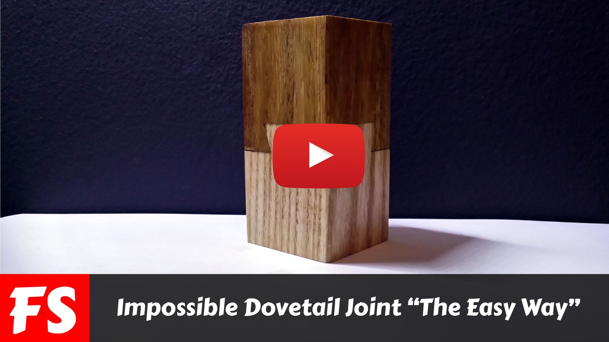

A few years ago I saw a puzzle like this somewhere on the internet and I was really amazed. The only problem I had was my woodworking skills. Now I think I am ready to make one myself, although the handcrafted version of it is quite difficult. So why not make one using power tools for ease and precision? Fortunately the only power tools that I needed were the ones we all have in our workshops. No fancy stuff here!

Here is a video of the whole process, please check it out first:

Step 5: Finished!
Just slide the one part into the other and you are good to go!
