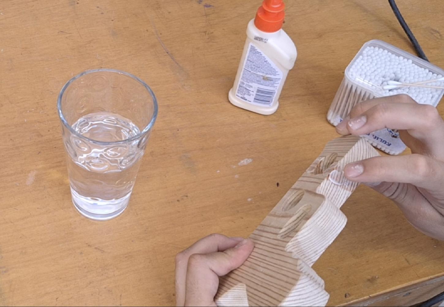

Step 7: Repair + Glue
I noticed a small piece had chipped when I broke the pistol. I glued it back carefully, making note of its correct orientation.
I was very careful to glue it back together and made sure it was aligned properly as best I could before clamping it tightly to let the wood glue dry.
Step 8: FAIL!
After the glue had dried, I scraped off the residual glue and sanded...and sanded...and sanded...but no matter what I tried, the gap was still visible. I even attempted to add more glue and sand in hopes the sawdust would stick and conceal the joint, but my attempts were futile.
I believe this happened due to a multitude of factors:
- How oddly the board had broken, I hadn't hit it very hard.
- A few splinters inside possibly didn't allow if the joint to be compressed enough.
- Imperfect alignment of the glue joint.
- Waiting too long causing the glue to expand the joint.
I suppose how swiftly you hit it impacts how likely it is to break across the path of least resistance - though I’m not sure if that’s even desirable.
