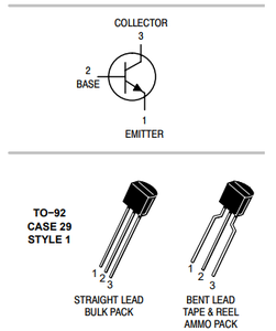

Then we will set transistor which will be used to display time. First, for the digit on the left, you will solder one transistor emitter on each plus of each segment, these will permit to choose the digit to show. I recommend you to bend the middle leg (base) since we will solder a resistor after.
You can now set a transistor collector on each digit on the minus which you soldered together just before. You have 4 transistors to add, soldering it on collector leg.
Now solder a 4,7kOhm resistor on each base leg (the middle one) of each transistor.
For better understanding of transistor, you can look here.
