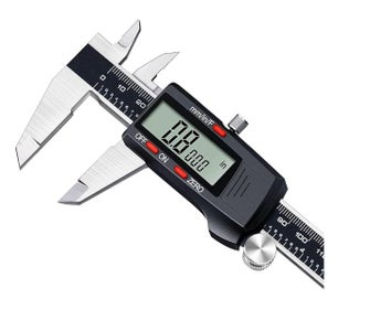

  • For this project, the supplies were fairly simple. I used a set of digital calipers to take the measurements, and my Ender 3 V2 to print the final model. You can use any filament as long as it is rigid but not so brittle that it cannot bend (PLA, ABS, and PETG are perfect; Avoid overly flexible filaments like TPU).
Step 1: Measure the Mounting Points
To get an idea of how the water bottle holder would mount to my bike, I first measured the diameter of the mounting screws used with the old holder, and how far apart the mounting points were. I also measured the diameter of the heads of the screws, so I could add counter-sinks into the frame of the holder.

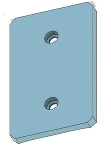

Step 2: Design the Mounting Plate in Fusion
For creating the 3D model, I chose to use Fusion because the complex geometry sketch tools allowed me to create exact curve profiles and chamfers. To start the design process, I modeled the mounting plate for my holder to be built on. I made the base curved so that it would fit securely to the frame of the bike and not shift around on bumps or turns. I then added counter sinks for the screws, so that they would sit flush with the mounting plate.
