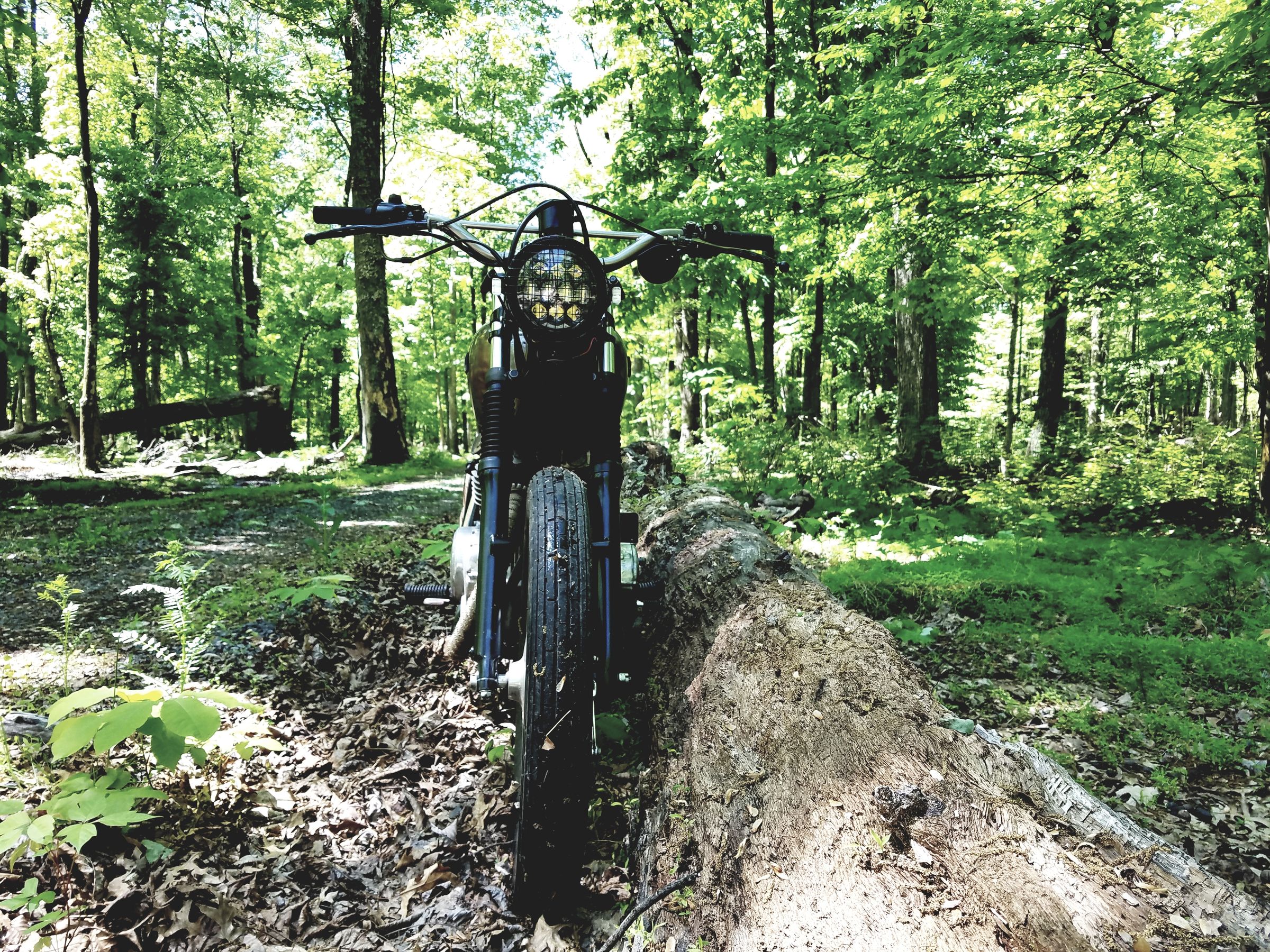

Step 6: Let's Go for a Ride!
It is crazy to think that this bike is twice as old as I am, and still runs like a dream. These vintage machines were built to last.
Although it is not the exact same bike from the walking dead, my 1981 Yamaha XS400, turns heads every time I ride through town. This bike is just super fun to ride. I don't think I could have picked a better first motorcycle to buy.
