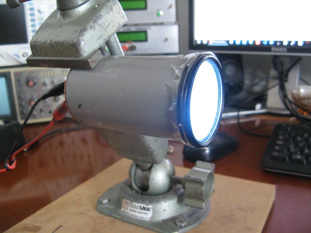

Hi Bradscopegems,
I tried with polarized light in the setup on my "optical table" (haha) but have failed. I used a white 10 Watt led mounted in a plastic tube with a polarizing lens at the other end. Shine that light on and through the wineglass. On the other side I first tried to see any effect with and without sqeezing the wineglass. With the polarizers aligned and disaligned, I didn't see any changes. Then I tried with a photo transistor but unfortunately also without any results. See the pictures. Should I try in some other way? Or do i need an other wineglass (with some build in stress)?

Reply 4 years ago
It wasn't the squeezing, I even managed to break a glass doing so (no I'm not hurt). It was that my filters are circular polarizers.
I didn't even know that existed, and I must say I have problems visualizing circular polarized light. Linear polarization is easy but circular? Do the waves (I assume we use the wave representation, not the particle) rotate? Like the first is vertical, the next rotated a few degrees, etc.?
My son came up with a good solution, 3D-glasses! One of his 3D glasses had to give up the polarizers and they work great, even somewhat better than the "official" 52 mm lenses. When you have them at 90 degrees almost no light comes through.
And it does work, when I squeeze the wineglass I see the amount of light increasing. I did manage to see the resonance of the wineglass, picked up with a photo transistor on my oscilloscope. I couldn't get it to work as an oscillator, but that doesn't matter, I have seen it working!
