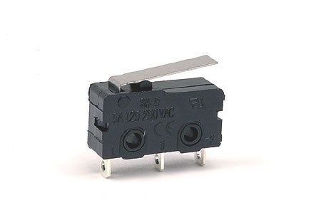

- Momentary switch

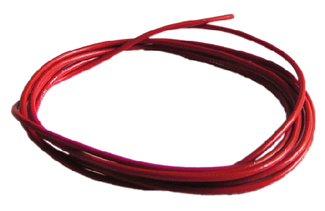

- Wires for circuits

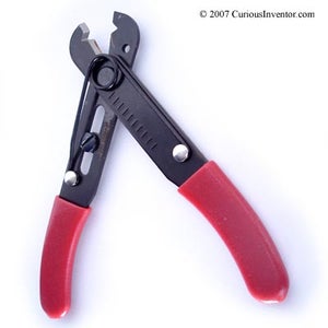

- Wire cutter

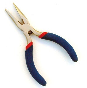

- *Needle nose pliers

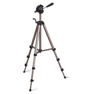

- *Tri-pod

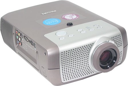

- *Projector (and a surface for projecting)

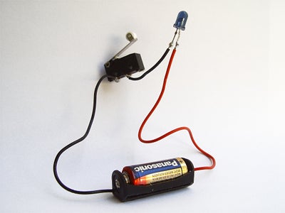

Now for the technical part, building the Infrared pen. Take the highlighter and disassemble it by taking off the bottom cap and pulling out the insides. You should be left with just the highlighter casing, which will be used as the Infrared Pen's body. Take the highlighter casing and cut it in half lengthwise with an Exacto-knife. You will need to make two cuts to completely split the casing. Put that aside and recreate the schematic (below) using your supplies. Keep in mind the anode and the cathode of the IR LED, the correct battery ends, the correct momentary switch tabs and the short length of the whole circuit. After that is complete, lay the circuit in the pen body and mark where to cut a spot for the momentary switch. Use an Exacto-Knife to cut out a spot for the momentary switch. Next, tape the circuit into the highlighter casing, and make sure that the IR LED sticks out of the top of the pen body. Tape the second half of the pen body to the rest of the pen body and and circuit, and in the process completing the highlighter form factor. Test the Infrared pen in front of a camera. When the momentary switch is activated, the IR LED should shine extremely light blue, but is invisibly to the naked eye. If the Infrared Pen does not work troubleshoot the circuit because that is most likely where the problem is.

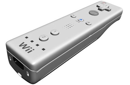

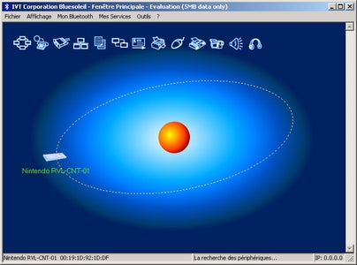

For Windows and Linux, if your computer has built-in Bluetooth your computer should have easy prompts to follow, if your computer does not have built-in Bluetooth, plug in the USB Bluetooth driver. Find and open Bluesoleil. Simultaneously press buttons 1 and 2 on the Wiimote, the 4 blue lights should flash. In Bluesoleil, click on the orange circle. Note: the Wiimote's lights must be flashing, if not, press and hold buttons 1 and 2 on the Wiimote again. When the device pops up, double click on its icon. Right click on the Wiimote icon and select Connect> Bluetooth Human Interface Device Service. Follow the prompts until there is a green dashed line connecting the Wiimote icon to the orange circle.
For Mac, the process is very different. Locate the built-in Bluetooth application. Turn Bluetooth on if it is not already on. Make sure that the Bluetooth settings are set to "visible." Simultaneously press buttons 1 and 2 on the Wiimote, so that the four lights flash. In the Bluetooth application, click "scan for devices" (or something similar). The Nintendo Wiimote's name should eventually pop up. Click on the name and register or pair with it. Open the actual Wiimote Whiteboard application. The program should immediately identify the Wiimote and connect it with the program. If part of this precess does not work make sure that the lights on the Wiimote are flashing or on at all times.

For a large projected image the process is very similar with a few changes. A quick fix is to place the Wiimote on top of the projector with it pointing towards the center of the projected image. This will not work for every configuration, but has worked most of the time for me. Otherwise, the Wiimote can be placed half way up the screen, off center three to five feet, back five to eight feet and pointing at the center of the screen. Adjust this placement as needed because it is very subjective. The Wiimote can be held in place by a tall camera tripod or a ladder, which will probably look tacky. You might also be able to attach the Wiimote to a ceiling, but the placement would obviously be a little different.
