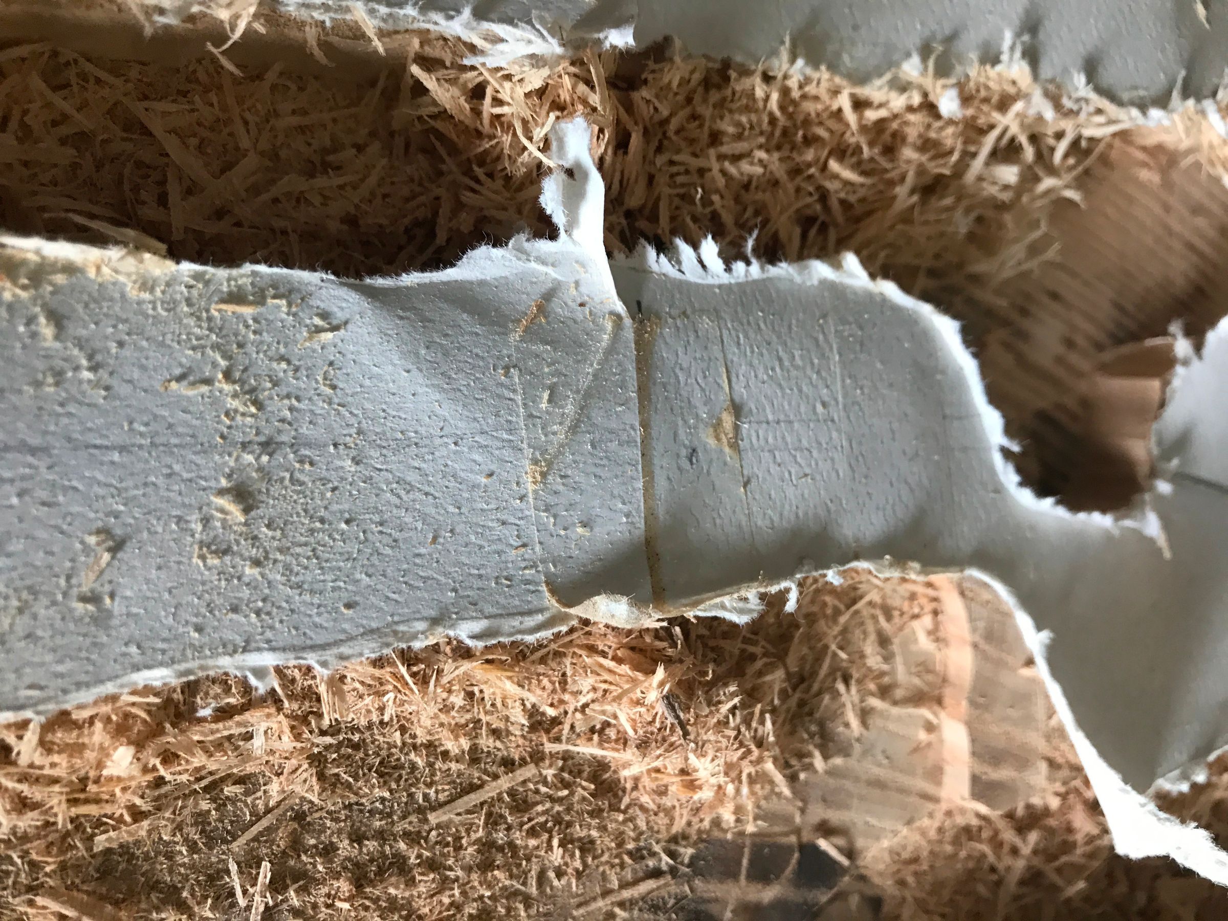

I traced the knives on my "map" of the drawer from largest to smallest, which I thought looked the best.

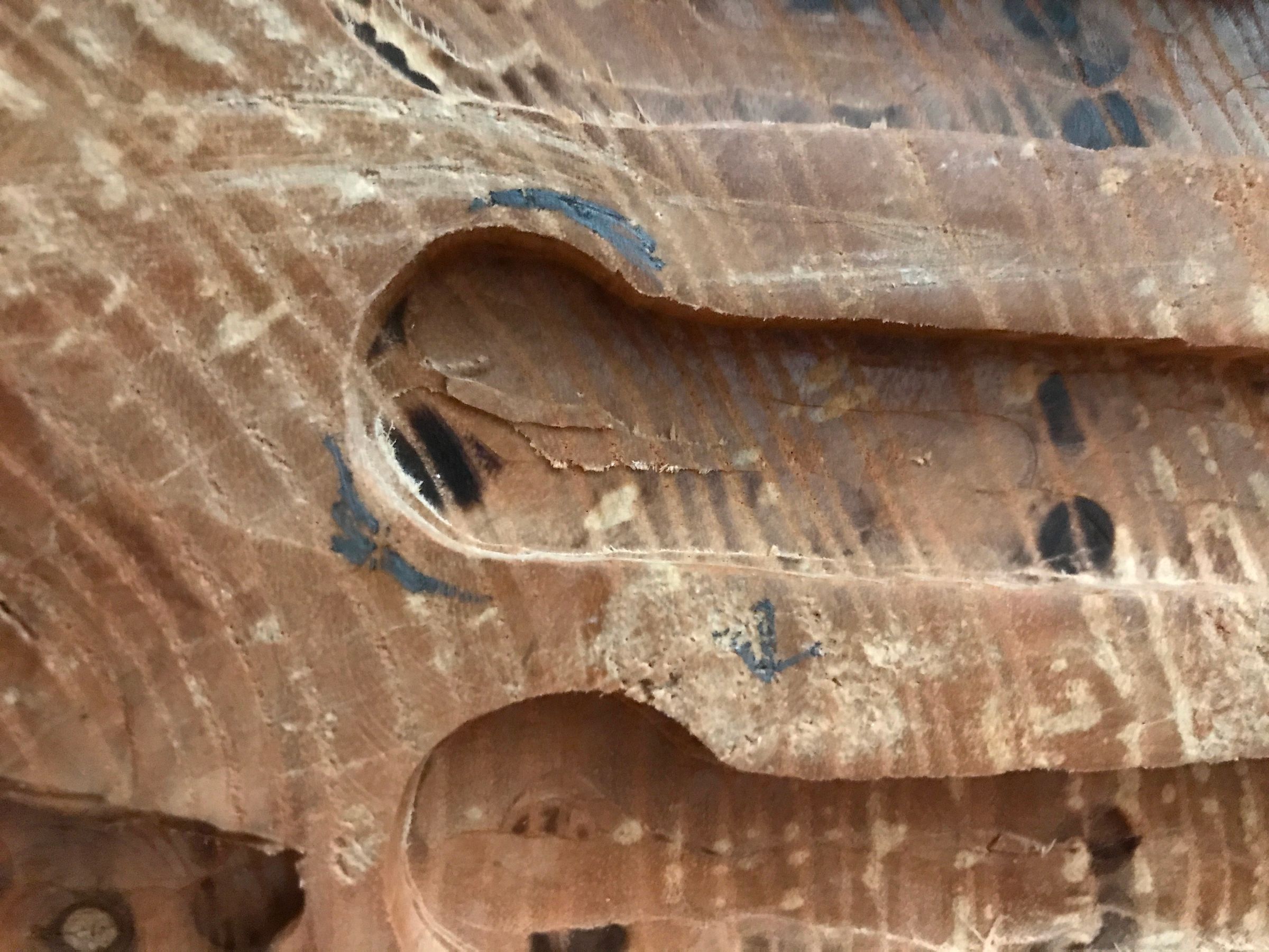

For most of the knife spots I used a 1/2 inch bit and plunged it about a quarter of an inch. Then I routed the rough shape of the blade part and did the same for the handle part only twice the depth.
The bread knife is laid out differently so it was a little bit trickier.

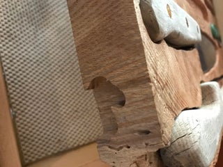

Once all of the knife spots were rough cut I put the actual knives in for a test fit. If they didn't fit very well I marked the spot with a pencil and used the router again.
Step 6: Details
Since the router bits make round cuts I used a chisel to make them into points and to remove any imperfections. Also, I used some medium grit sandpaper to remove some of the burn marks caused by the router and to round some of the edges.
After test fitting it in the drawer I realized that the drawer handle bolts interfered with the piece of wood so I went back with the router and removed some material to make it fit.
