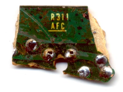

Step 1: Circuit Board
The circuit has to be assembled on a circuit board. I find that a piece broken off a larger board will be sufficient. It has green solder mask on, in fact it is part of a large Y/C panel from an old VCR.

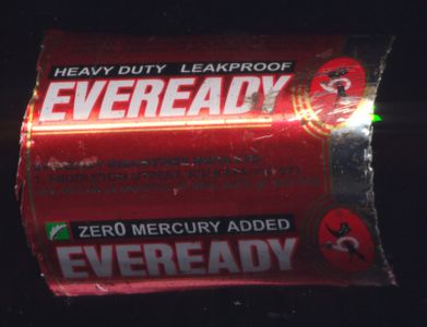

It will need something to hold the circuit board, a battery and the headphone socket. I shall use a AAA cell to power it, and use the metal cladding from two AA cells to fabricate a suitable cover for these.
It is the only way to end up with an assembly little thicker than the battery powering it.
The picture shows the metal cladding being liberated from a couple of dead AA cells.

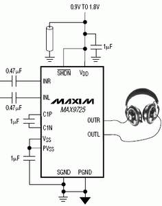

Step 4: The Circuit
The figure shows the circuit, which has been unashamedly copied from the datasheet published by MAXIM for their chip. In addition to the chip and battery, five capacitors need to be fitted.
It would all be very easy, but the chip is intended for surface mounting and very small.

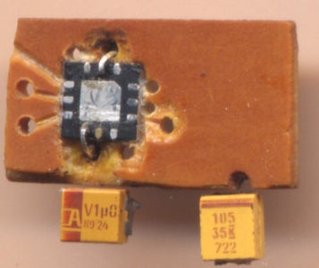

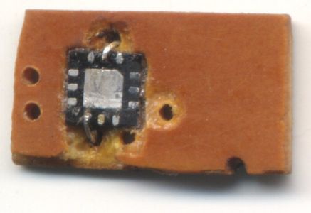

Step 5: Whittle a Circuit Board
A small (jewellers') screwdriver was sharpened into a chisel and a recess dug out of the component side of the circuit board. This board is made of paper laminated with phenolic resin, and it cuts with the chisel very easily. And I like the feel of cutting through it - absolutely unnecessary for the proper functioning of the circuit, I am sure, but it gives me something to do and makes the finished product look as if somebody spent some time on it.

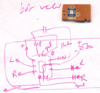

Step 6: Wiring Scheme
I shall be looking at the underside of the chip, so a scheme of connections is prepared looking at the chip that way.
The data sheets show the connections looking down at the top of the chip, and it is possible to make mistakes if wiring directly from that.
The view below has been labelled "bot view" and the board shows the chip securely inside its recess, and a few holes drilled for the connecting wires.

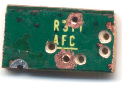

Step 7: The Other Side
The other side of the board shows the holes, the solder resist scraped away for the wires that connect to ground, and the copper bevelled away for those wires which do not.

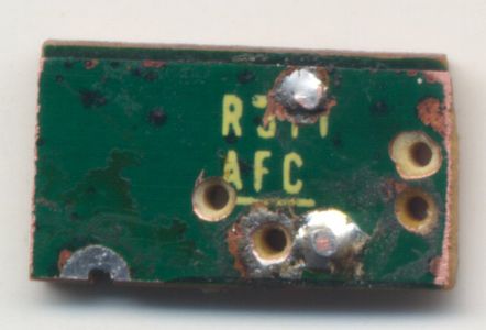

Step 8: Soldering Wires
Two wires that connect to ground have been soldered in this picture.

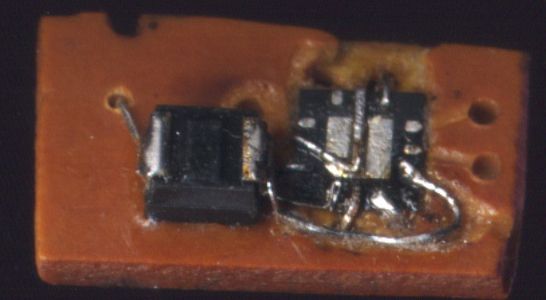

Step 9: Soldering to the Chip
It needs a steady hand, a fine tip on the soldering iron, and good lighting in order to place the wires and solder exactly where they have to go.
The other end of the wires have been soldered to the foil and so they stay put while they are bent over the chip, cut to size and soldered to the pads.
I use a watchmaker's eyeglass for this part of the proceedings in order to see what I am doing.

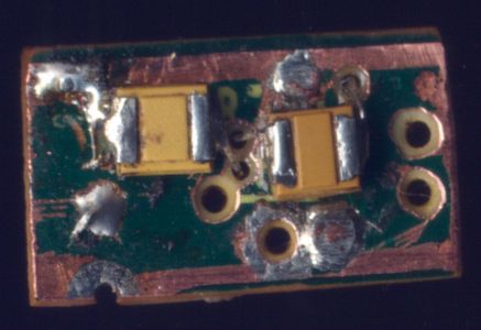

Step 10: The Capacitors
Two capacitors from old hard disk drives have been liberated to be used in this circuit.
I have drilled a few more holes, and cut a few channels for the wires in this picture.
Both those capacitors are tantalum, surface mount, 1 microfarad.
Step 11: In Position
The capacitors have been soldered in position in this picture.

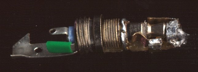

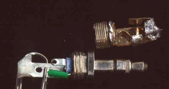

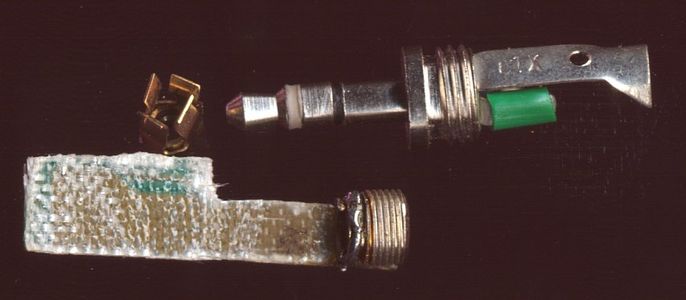

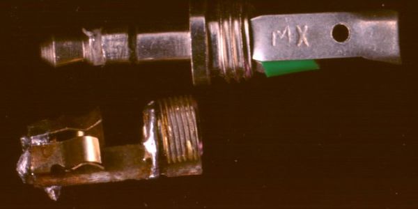

Step 18: Socket for Headphones
The socket for the headphones is to be made of parts from an old one to fit in the diameter of the AAA cell.
Step 19: Tip Connector Fitted
The spring connector contacting the tip of the jack has been fitted.
Step 20: Tip and Ring Contacts Fitted
The tip contact was modified, and the contact for the ring on the jack has been fitted.
Step 21: It Fits!
The jack inserted into the completed socket. It seems to be okay. It has to be inserted with a bit of Tender Loving Care or the thing might come apart.
