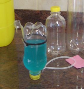

Step 2: Bottle
Look for a PET plastic bottle, transparent, thick and durable, with ergonomic design providing a flange that helds the nylon tie.
There are plenty of refreshing drinks served in small format, This is a small bottle of soft drink (33 cl. or similar) with threaded cap.
Mark the filling levels of each one of the components using a scale or a volume meter.
Put the bottle of 33cl in a kitchen scale and fill the bottle with water. Mark the levels at 260 and 280 grams. Empty the bottle after doing that.
When we do not have a scale or volume meter, we'll mark approximate levels to 3/4 of the volume and a little higher; the figure will give you an idea of the proportions.

Step 7: Install the Device in the Tank.
We put the bottle in the tank. Be careful to position it in a place that does not get in the way of the mechanisms, buoy or discharge valve.
Is regulated according to the submerged depth; will expel much more cleaner when more immersed we place it.
In installations that I have in operation, initially we have placed the bottle as high as possible, as is allowed by the lid of the tank, being submerged only a third or fourth part of the disinfectant. Thus it is sufficient, the water is slightly acidified and cleaning is very satisfactory.
Some time later, after a few months, the solution will lose strength so we will dive the bottle a little and it will continue maintaining all of its cleaning power.
If there is a lot of dirt stuck in the bowl when we place the device, will go descaling with the passage of time, plus occasionally we'll scrub with the brush, after a few weeks the toilet will shine. We may help cleaning if we apply a little gush of hydrochloric acid under the rim and let it work its way down. Close the lid and let the cleaner soak in the bowl for some hours; after scrub with the toilet brush. We must be sure that the hydrochloric acid is applied only over the inner porcelain bowl and not on other parts, therefore avoiding the risk of damaging metals or chromed plastics.
