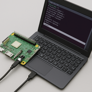

  4. AND OUR RASPBERRY PI.......
  5. AND IT'S PERIPHERALS........................
1) Get a Single Board Computer (small and which doesn't produce a lotta heat or your head will hurt) .......

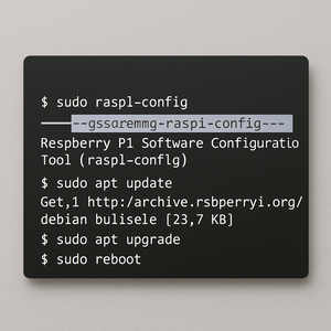

2) Configure the SBC...

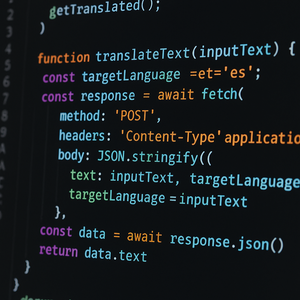

Step 2: Code
Now what do we want to do?
The aim is to build a cap which translate what you hear or see.
So, we'll use VOSKandTesseract OCR to get our job done for speech and image respectively. We'll use Helinski or Google translate for translation
Here's the code, and if you want me to explain the code, please comment as I'm running low on time.
Please install the following libraries on your pi but first create a venv.
