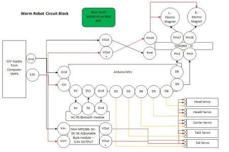

Step 12: Circuit Plan
The picture is self Self explanatory, Which pins are connected with which servos and for control magnet use ULN2803 IC. Make the circuit as small as possible because the circuit must fit inside that small head and tail.
Step 13: Prepare and Connect Circuit
Solder the circuits using thin wires because lot of connection in this project is use normal wire the wire become a big bundle. Check the circuit with the worm arrangement. For that first want to complete the program.

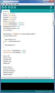

Step 15: Arduino Program
Click here and download the Arduino program file from google drive
As per the command received from the android change the position of the servo. For speed control smoothmove function is inside the program increase and decrease the speed by change the smoothdelay in program as per the command receive from android app. Main thing want to check is while magnet hold that leg want to be straight in with the floor.
Download the code from the above link and upload it to the arduino mini pro. Now the worm is ready for test.
