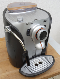

I like my (quite) old relyable coffeemachine, but the temperature of the coffee was a little low. In this Instructable I show you how I increased the temperature of the coffee

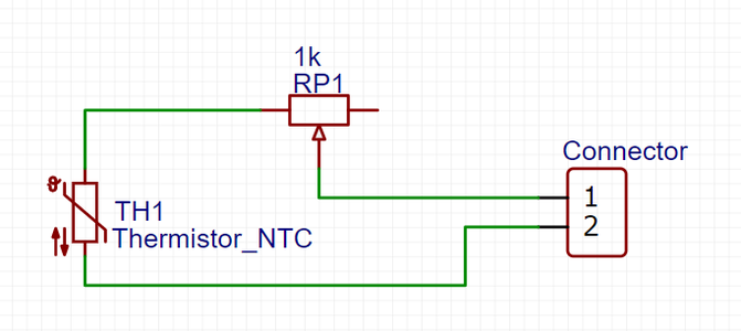

If the resistance of the NTC at the required temperature was 3 kOhm (for example), if I could increase the measured resistance to 4kOhm, the coffee machine would measure a lower temperature and would heat the heating block more to get a lower resistance (3 KOhm), and therefore I would get hotter coffee.
I simply increased the resistance of the NTC by adding a resistor in series.
Based on some of my temperature and resistance measurement, using this site (https://www.lasercalculator.com/ntc-thermistor-calculator/) I calculated that I needed a resistor of about 0.5 - 1 kOhm.
I chose to use a potmeter which I installed on an accessible position. Via the potmeter I could increase the resistance further to increase the temperature further or I could reduce the resistance to 0 ohm to get back to the start situation.
Step 2: Connecting the Potmeter
The thermistor is connected via 2 wires. I cut one of the wires and added a loop to 2 legs of the potmeter. The initial resistance of the 1 kOhm potmeter was 500 Ohm.

I found out the the water was about 5 deg C hotter than it initially was, so for me this is a great solution, no need to replace my coffee machine.
