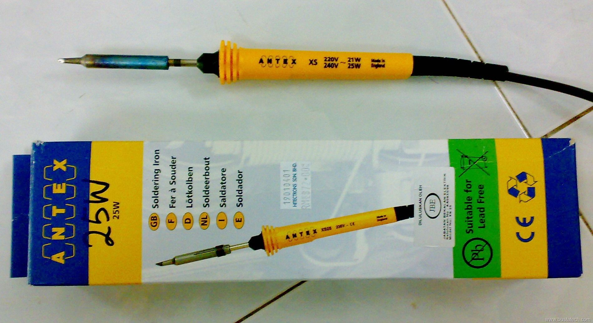

Step 2:
So, to make the IR LED expose more outside the case, you will need to de-solder the IR LED from the PCB board. A de-solder sucker should help you easily remove the IR LED.
