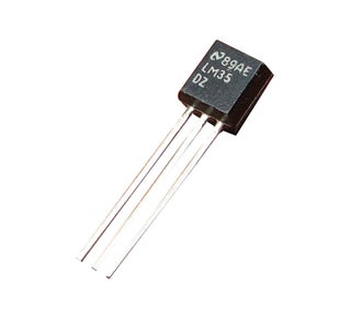

2. LM35 Temperature sensor

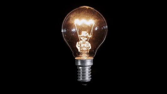

5. Bulb with wire,plug, and holder

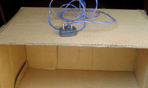

Step 2: Making of Incubation Area

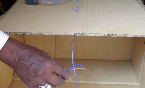

1. Take a wooden/card board box.
2. Make a small hole on top of the box.
3. Insert the power supply (life and neutral) wires through the hole inside the box.

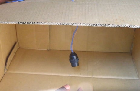

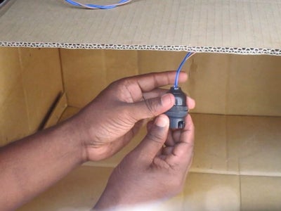

4. Connect the holder of the bulb with the wires and fix the bulb in the holder.

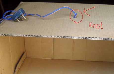

5. Make a knot at the top of the box using the wires, so that the bulb will be hanging from the top of the box.

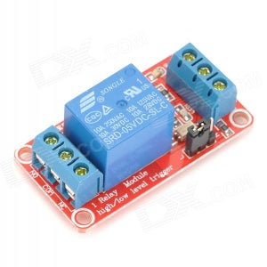

Relay Pins
VCC to Arduino pin 5V
GND to Arduino pin Ground
IN to Arduino digital pin 4
COM to One terminal of the disconnected Lifewire of the Bulb
NO to Other terminal of the disconnected Lifewire of the Bulb
· (The relay is considered as the relay that connects COM and NO pins when HIGH input is given to the IN pin. Some relays do the same function when LOW input is given to the IN pin. In that case you should connect the second terminal of the Lifewire of the Bulb to the NC terminal of the relay instead of NO terminal)

LM 35 Temperature sensor
Pin 1 (left side pin from the face) - Arduino pin 5V
Pin 2 (middle pin) - Arduino analog pin A1
Pin 3 (right side pin from the face) - Arduino pin Ground

Note: Please calibrate the temperature value with the real temperature. Sometimes LM35 can show you a different temperature value from the real value.
