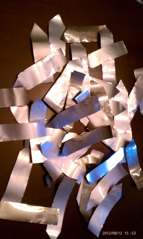

4) Hold the pieces together. Cutting two pieces is actually easier than cutting a single piece. Trim off the jagged, uneven edges
Step 5: Cut Into Thirds.
5) Now with two nearly even pieces, begin to cut into thirds for your plant tags.
