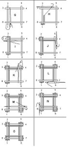

Step 2: One-Square Pattern - Filling the Braided Grid.
Once the braided grid is complete, the filling pattern is created.
For this work, use a blunt needle and a contrasting color of embroidery floss so that the braided grid is distinct from the filling yarn. This minimizes major mistakes, or rather, allows for quick identification and correction.
Drawings G to N show how the filling pattern is woven into the braided grid completed in the first phase (drawings A to F).
The filling pattern is also braided, i.e., the thread is pushed under the thread below and placed over the thread above. Only with these steps does one realize how important it is to work the braided grid precisely. If the braided grid was braided correctly in the first phase, no further mental work is required in this phase.
We start at 1. The needle goes over the thread 1-2 and under the thread 8-7 at the corner 8-1. Then the needle goes over the thread 3-4, under the thread 2-1, over the thread 3-4. This procedure repeats at every corner, until we reach back to the point 1.
Remember, it is like weaving.
The braided grid making should be practiced, until you are confident. It's important to stitch the braided grid precisely. Mistakes should be carefully corrected, even if it's sometimes difficult to undo the work you've already stitched. Later, you'll be glad you did it. Once the braided phase is stitched flawlessly, filling it is no longer difficult.

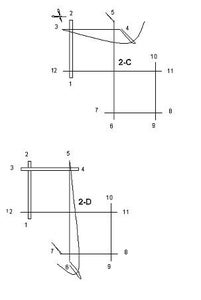

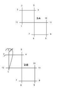

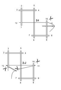

Step 3: Two-Square Pattern, Making the Braided Grid.
Drawings 2-A to 2-K demonstrate how to construct the grid of two squares. If necessary, you can use scissors to determine whether the new thread should be placed above or below the existing thread. You may have noticed that the direction of the needle changes at some corners. The placement of the new thread also changes here.
I think the drawings are selfexplanatory, so I leave it to you to practice making the Two-Square Pattern

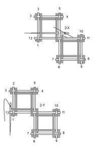

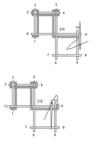

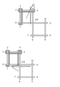

Step 4: Two-Square Pattern, Filling the Braided Grid
After completing the braiding grid for the two-square pattern, filling begins as we already practiced with the one-square pattern. Here we learn the transition from one square to the other. The rule is: when you reach a corner where another square joins, the transition into the new square takes place.
The drawings above illustrate how it's done. Drawings 2-L to 2-Q are similar to drawings G to L and are not difficult to understand. In drawing 2-Q, you enter the second square. Braiding continues now in this square. Drawings 2-R to 2-W show how to braid the second square. Drawings 2-X and 2-Y illustrate the braiding for the remainder of the first square. Drawing 2-Z then shows the finished braided two-square pattern.
When filling the braided grid, it's important to practice the transition into the adjacent square thoroughly. The patterns 2-Q and 2-X are especially important to remember.
It's very important to set up the grid precisely, the braiding then happens more or less automatically. The underlying threads are lifted by the braiding thread sliding underneath them.
The finished two-square pattern clearly shows that the embroidery pattern is being braided, with the braiding thread moving over and under the existing threads.

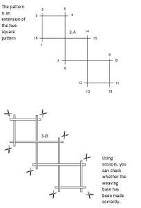

Step 5: Three-square-patterns
Build and fill the braiding grid.

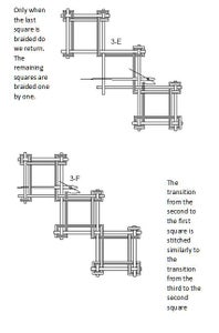

The next step is the three-square pattern. There are two variations of the three-square pattern. We'll start with the simpler version. The three-square pattern to be embroidered is shown in Figure 3-A. It is simply an extension of the two-square pattern. The finished grid is shown in Figure 3-B.
A step-by-step description will be omitted here, as it is an extension of the two-square pattern. The scissors are shown in the correct position to help you.
Figures 3-C and 3-D show the transitions to the adjacent squares, and Figure 3-G shows the finished braided grid.

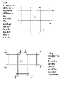

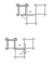

Step 6: Three-square-patterns Variation
Drawings 3-H to 3-Q show the variation of the three-square pattern. Drawing 3-H shows the pattern to be stitched, drawing 3-I the finished braided grid, and drawing 3-Q the finished braided pattern. In between drawings 3-J to 3-P show the transitions from one square to the next.
Once you have practiced the first variation of the three-square pattern, it is no longer difficult to braid this variation. The arrangement of the squares may be different, but the braiding principle remains the same. When you reach a corner where a new square begins, you first branch out into it and then braid it.

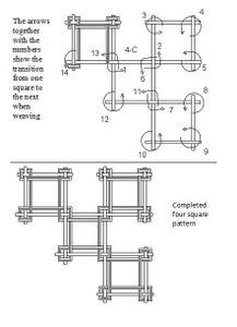

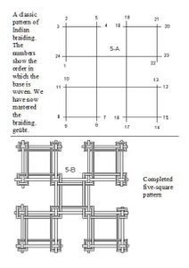

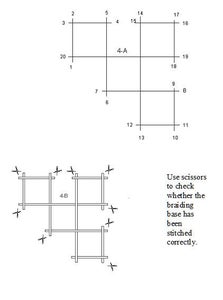

Step 7: Four and Five Square Patterns
Four- and five-square patterns
The drawings above show how these patterns are stitched. The principle of braided stitching and filling remains unchanged. Therefore only the important operations where difficulties might arise are shown.

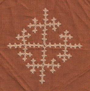

The five-square pattern is very typical of Indian braided embroidery. This pattern is often the basis for other, more complex patterns. See Fotos 3 and 4.

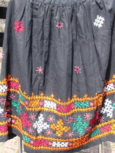

Now you are in a position to draw your own patterns. Use these Fotos to get inspiration.
To start with use coarse material like linen or jeans
The same color and thread thickness can be used for both phases. By using different colors and thread thicknesses, beautiful effects can be achieved.
