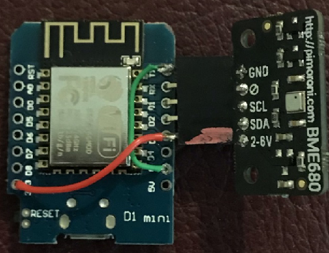

Step 2: Wiring Diagram
Wiring Diagram

Step 4: Connect Everything
OLED
VCC - 3.3v
GND - GND
SCL - D1
SDA - D2
BME680
VCC - 3.3v
GND - GND
SCL - D1
SDA - D2
Since both the sensor and the OLED are connected using I2C, they are connected to the same pins. In order to do that you can cut a dupont cable in half, and solder the cables to have some Y shaped cables.
