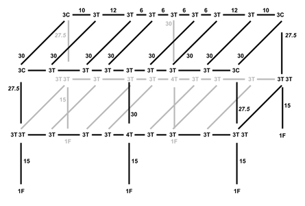

Step 1: Overview
This diagram gives you an idea of how all of the parts fit together. It shows where each of the connector types is used, and the lengths of the tubing. It's not exactly to scale, so don't get hung up on that.
The basic idea is the frame supports 6 cross beams at each level that the LED panels are attached to. Each pair of cross beams are about 12" apart, the size of the LED panel. That makes it easy to attach the panel to the cross beams using zip ties.
The first level of lighting is on the table top itself, and the second level is at the ground level.
If you decide you don't want 2 levels, then you can adjust to not have as many cross beams (and connectors) on the lower level. Though you may still want a couple to provide stability.
You can adjust the distance of the panels from the plants by either hanging the panel using longer zip ties or by adjusting the lengths of the tubing at the corners are center or both. Adjusting the height using zip ties (or some other mechanism) is the most flexible.
I'm going to be doing this instructable for 2 levels since I have found that I can never have enough space to put plants.

Step 3: The Assembling - Part 1
Start by assembling the lower level. Lay out the tube lengths and connectors, as shown in the diagram, and then dry fit them together. I found it easier to put together the two long sides first (10", 12", 6", 6", 6", 6", 12", 10") and then to connect each side using the 30" cross beams. And then attaching the 15" legs. The 1F end caps go on the end of each of the 15" legs.
The only tricky part here is the use of 2 3-way tees (3T). On the diagram you will see that at each corner of the frame there is a "3T 3T". They don't make a connector that will connect a corner and connect a top and bottom tube (or at least they don't sell it at Home Depot). So, I use 2 3-way tees. The bottom 3T connects the long sides and has the leg out the bottom. Then connect the top 3T to the bottom 3T using the 1.25" tubing, and use the top 3T to connect the side cross beams. And eventually the top level will come from the top of the top 3T. I know this sounds confusing when you are reading it, but look at the pictures above to see how it works. It will make sense when you go to put it together.
