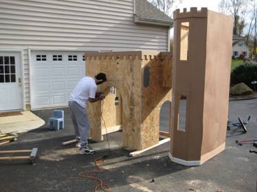

The top level has a nice large carpeted play area that leads you across a bridge giving access to the tower with fireman's pole. (Picture 2)

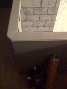

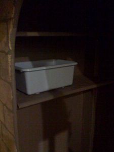

After sliding down the pole you find two built in shelves in the tower for storage and a side entrance to the main castle hall. (Picture 4,5)

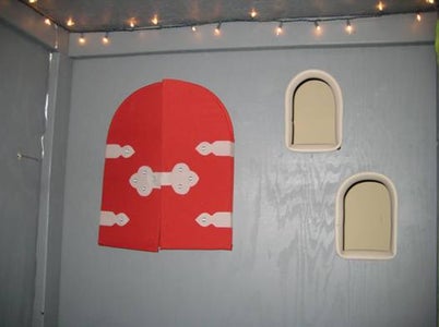

Inside the main hall we have a nice dragon tapestry covering the back wall and a medieval looking mirror. (Picture 6) Just inside the front door is a push button light switch that controls the inside string lights and outside torch lamps. (Picture 7)
The front has two plastic torches that actually flicker for a great effect. A wooden shield is attached above the main door which was saved from my childhood. The tower has two long thin windows resembling the archers windows used in real castles.

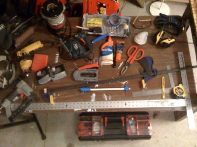

Step 2: Tools and Materials
Here is a list of the tools and materials I used for this project

Tools
Craftsman table saw with roller stand
Jigsaw
Drill with bits
Craftsman belt sander
Tape measure
Rulers
Hammer
Saw horses
Craftsman router
Craftsman table saw
Circular saw
Staple gun
Cutting shears
Clamps
Paint roller/brushes

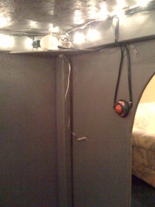

- When cutting the opening to the upper deck leave some space over the top floor level to account for the carpeting and padding. (Picture 1)

- The top handrail is 1x4 cut to lenght with 45 degree angles. It was glued and nailed once inside the house. (Picture 2)

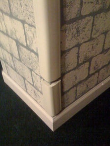

- I was able to build the tower in one piece because of it's width. (Picture 3) Framed out with 2x4's as seen in my drawings I covered one side in 3/4" plywood and the other in 1/8 sheeting. I used MDF on the front angled pieces because I already had some, but there is no special reason. Setting my Craftsman table saw blade on an angle, I tried to cut the wood to make a smoother corner. But as you can see from all the filler, I didn't do a very good job. The firemans pole is secured to a 2x4 across the bottom and top using brackets. (Picture 4) The hole was cut as wide as the tower (2 feet) using a very large compass and jigsaw. (See picture of tools) The shelves where made from plywood cut to fit and I used 4 gray shelf angled brackets. (Picture 5)
- If you have the room or can take it outside like I did. I recommend putting it all together once before disassembling and installing. This gives you the chance to make sure everything fits and then sand, sand and sand some more. (Picture 6,7) It's also a good time to give it a coat of grey primer.
