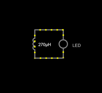

Step 5: Circuit
The basic circuit design consists of an air core coil and parallel wired LED.
The red LED is a surface mount 2mm x 0.775 mm.
The coil (~270uH), is made up of ~200 turns of 0.15mm (dia), ECW wrapped on the central form.
An estimation of the coil inductance can be derived from Brooks formula: L (mH) = 1.6994x10e-6 x (R*(N^2))
Where: R = mean radius of winding (mm) , N = number of turns.

Step 7: LED Wiring
Solder the two wires from the coil to the LED.
Separately or inaddition to testing with a meter verify operation with a coil.
Test the LED and coil by placing the coil in the centre of the wireless charger the LED should flash. If it does not flash check for shorts and/or opens with a meter.
If everything is fine at this stage apply clear lacquer or varnish to hold the wiring in place.

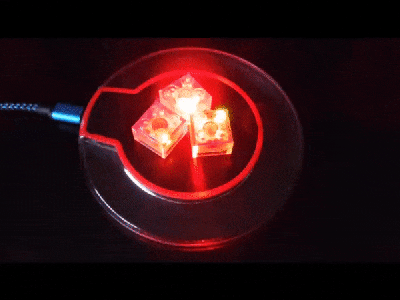

All that is left to do is push the coil former over the brick column such that the flat side of the coil former is facing out of the brick.
Step 9: Operation
Plug in the wireless charging pad into the appropriate power source.
Place the brick dimple side up on the wireless charging pad and the led will flash.
Step 10: Finally
You can now enhance your LEGO projects with wireless lighting.
