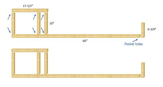

For this project I used three 2 by 2's. I started by making all my cuts as per the cut list below using my miter saw.
CUT LIST
- 2 @ 60" (back legs)
- 6 @ 10" (horizontal leg braces)
- 2 @ 27" (underside cross braces)
- 2 @ 6-3/4" (top shelf support)
- 2 @ 17-1/2" (front legs)
I laid all the pieces out as per the diagram so I could mark where to drill the pocket holes (blue arrows). I marked them on the underside or backside of the frame in order to make sure they wouldn’t be visible. I then used my Kreg Jig to drill all the holes.
Before assembling the pieces, I also made some pilot holes so I would be able to screw down the bench from underneath later on.
I proceeded to assemble each side of the frame using 2-1/2” pocket hole screws with the help of my Ridgid compact palm driver.
