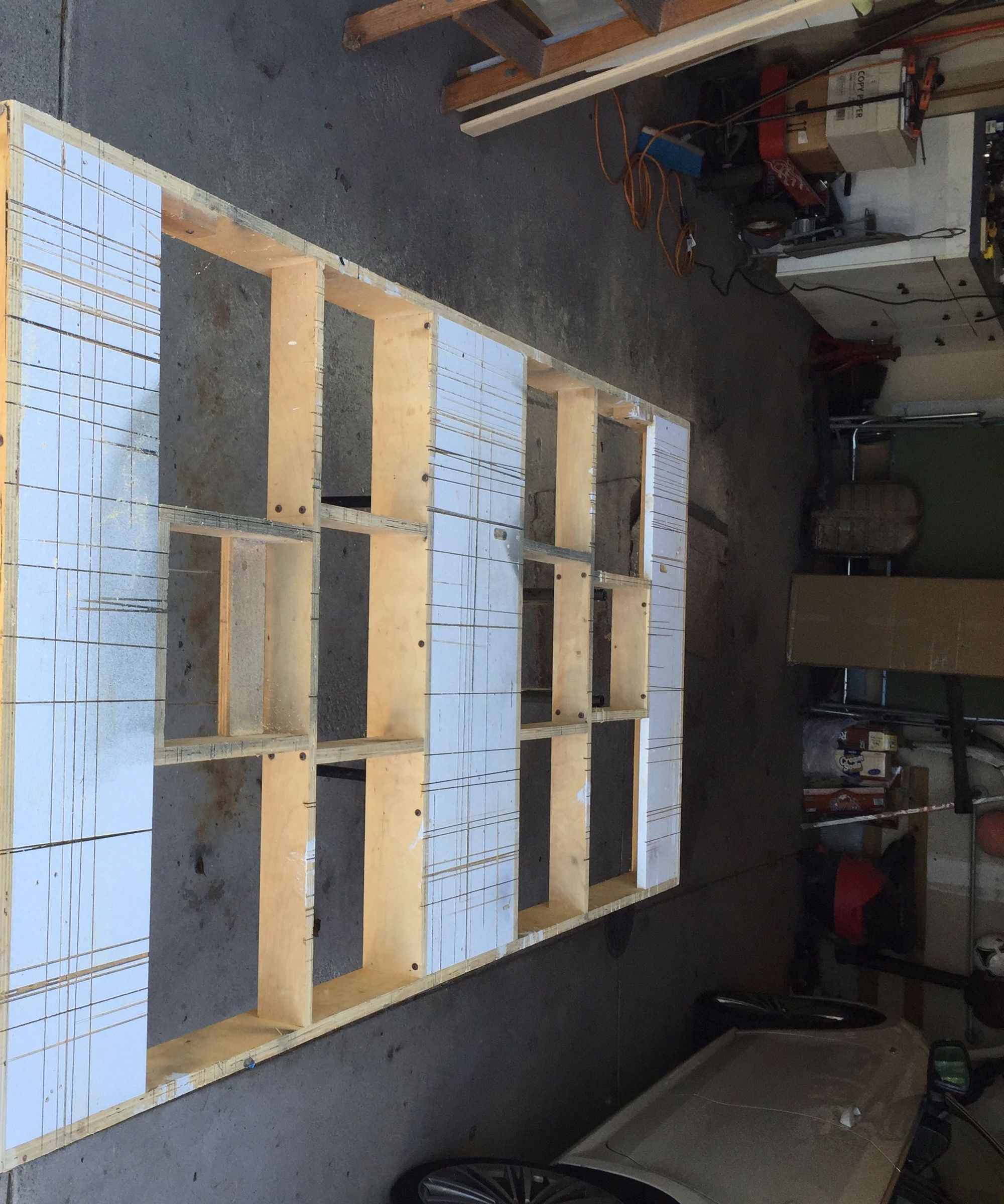

I cut one of the boards up into eight separate 9 inch squares. I cut the MDF using my cutting table and a circular saw. (See link below)
https://www.instructables.com/id/No-Table-Saw-No-Problem-Build-a-Portable-Cutting-T/
