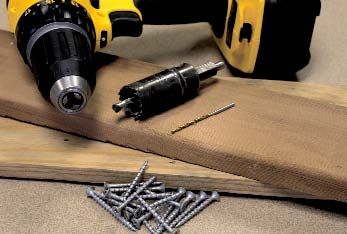

Step 1: Bill of Materials
Collect your materials:
Purchase:
One:23” 1x6
One:18” 1x4,
Eighteen:1 1⁄2” wood screws
Techshop:
Drill
Table saw
Drill Press
Purchase:
One:23” 1x6
One:18” 1x4,
Techshop:
Drill
Table saw
Drill Press

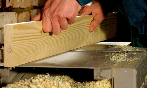

Step 2: Mill Your Stock
Using the plainer joiner, mill your stock to a 1/2"

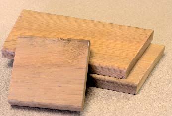

Step 3: Cut the Following Pieces
Using the table saw or circle saw, cut out pieces of the following dimensions: \
Cut the 1x6 into three lengths:
10” (for the back),
6 1⁄2” (for the front),
6 1⁄2” (for the roof).
Cut a 15 degree angle on one end of both of the 6 1⁄2” sections.

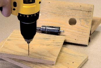

Step 4: Drilling
Using a hand drill, pre-drill all of the screw holes to pre- vent the wood from splitting, and drill two holes at the top for mounting. Using the drill-press drill out a 1” hole for the entrance.

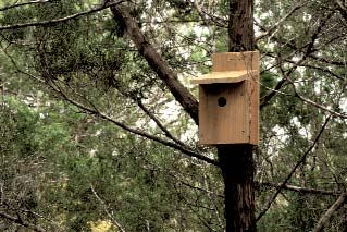

Step 5: Assembly
Assemble by screwing all of the pieces together. For seasonal cleaning, remove the four front screws to open up the box.Hang your completed birdhouse in a protected, yet visible spot so you can observe and enjoy the birds that it attracts.
