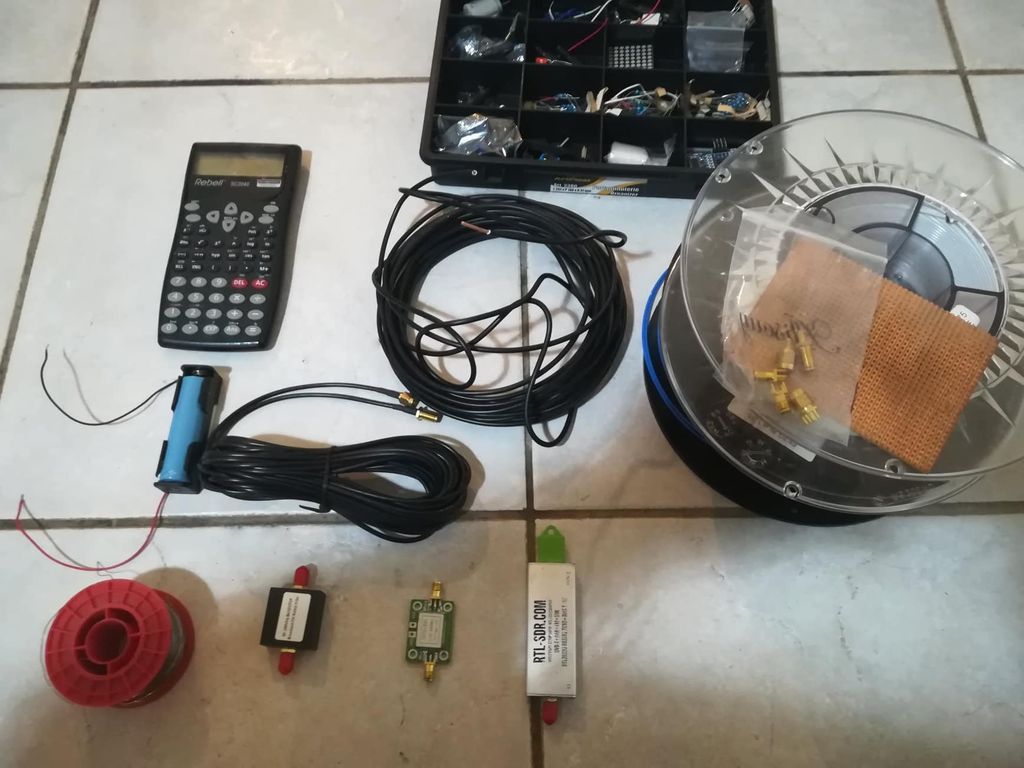

You will need:
1. RTL-SDR, AliExpress
2. FM Band Stop Filter 88 - 108 MHz, AliExpress
3. SPF5189Z LNA, AliExpress
4. 1 m of PVC pipe with a diameter of 25 mm.
5. ~200g 3D Printer Filament, I used PETG for its durability.
6. 5 m copper wire with a diameter of ~2 mm.
7. A 50 Ohm transmitting line (RG174, RG58, RG178).
8. 50 Ohm RF connectors corresponding to your SDR and transmitting line (in my case SMA for RG174).
9. A 5.4 pf capacitor (I used 2 capacitors with 2.7 pf capacitance in parallel).
10. 0.5 mm wire to create a 248 nF coil inductor.
11. RF connectors for PCB.
12. A 18650 battery to power the amplifier.
13. A laptop or a desktop running SDR reception software (GQRX, CubicSDR, SDR#) and APT decoding software (WXtoImg).
14. A soldering iron.
15. A drill.
16. A crimping tool.

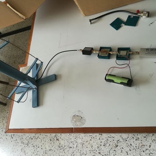

These are the things you are going to need in case you want to copy my system, alternatively you can just use the antenna and a transmitting line to connect it to the SDR. The reception will still be good!

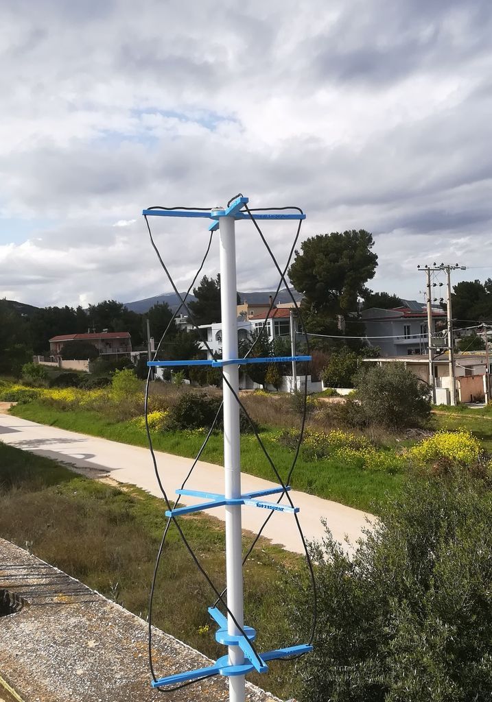

Step 1: Printing and Building the QFH Antenna.
A QFH (Quadrifilar Helix) is a circularly polarized antenna and consists of two loops which form four helixes, to receive the APT signal we need a QFH with right-hand circular polarization (RHCP). Since the antenna is used as a receiver, the source should be on the top. Download and print QFH_BOTTOM 2 times, download and print QFH_BODY as many times you need to guarantee that the loops form helixes ( I printed 3) and cut 2 pieces of 2.5 m wire. Ideally you need ~2.20 m (2203 mm) of wire for the longer loop and ~2.16 m (2158 mm) of wire for the shorter loop but it may be easier to cut longer wires and then match them to the body of the antenna.
- Fit the first printed QFH_BOTTOM part to the PVC pipe and place it close to the bottom.
- Fit the second printed QFH_BOTTOM part to the PVC pipe and place it 45 mm far apart from the first.
- Fit the printed QFH_BODY parts to the PVC pipe, the distance between the top part and the bottom QFH_BOTTOM part should be 742 mm. You should fit the rest of the QFH_BODY parts between them, the distance between them doesn't matter but you have to make sure that the wires form four uniform helixes.

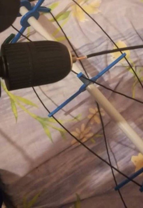

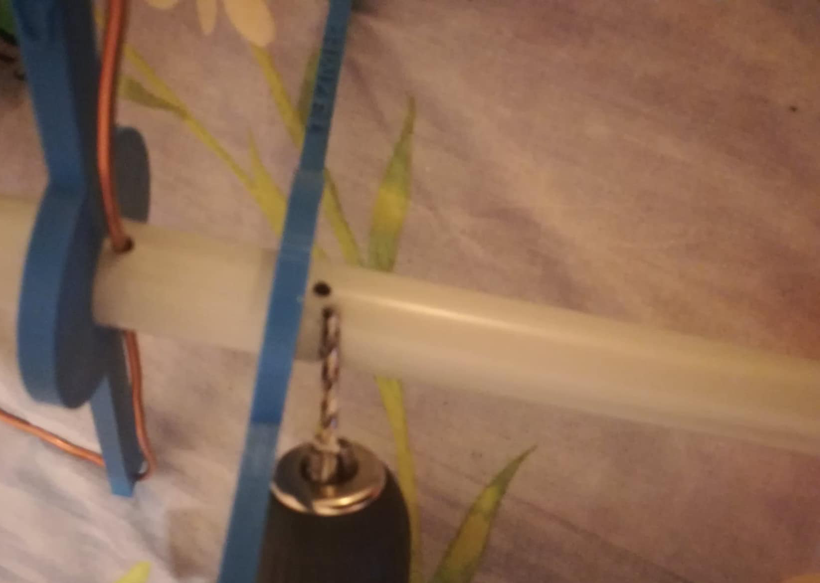

- Drill holes below the first and the second QFH_BOTTOM part so the wire can pass through the pipe.
- If you want, you can use the drill to straighten the wires after you have placed them to the antenna body. Be careful and don't apply too much pressure as you may break the wire and hurt yourself!
- Form the helixes in right hand motion as it is shown in the picture below.

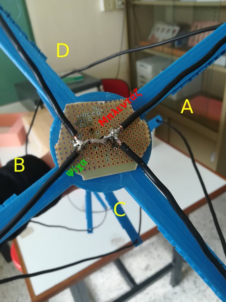

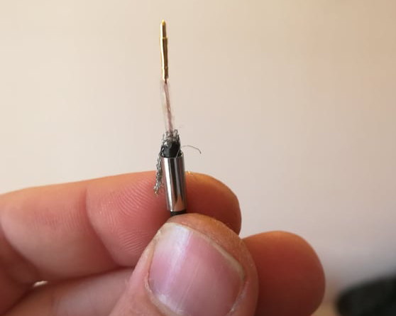

- Stip your transmitting line.
- On the top of the antenna, solder one end of the longer loop and one end of the shorter loop with the center core of the coaxial line.
- Solder the remaining ends with the shield of the line.
10. Make sure there is no short circuit (the core is completely isolated from the shield).
11. Strip the other end of the line and use the crimping tool to fit it to a RF connector that matches your needs (male RP-SMA for RG174 in my case).
The standing wave ratio (SWR) of this antenna was measured to be 1.27 for 137.5 MHz using an Agilent E5062 vector analyzer.
The input impedance of the antenna was measured to be ~50 Ohm.

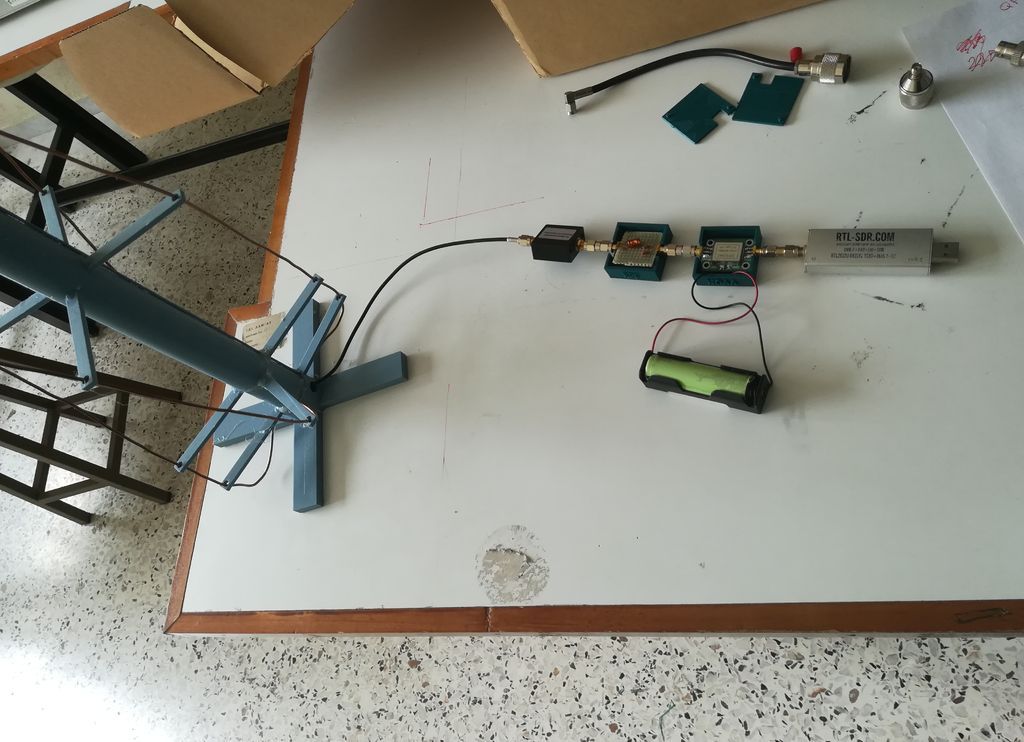

Step 2: Filters and Amplifiers.

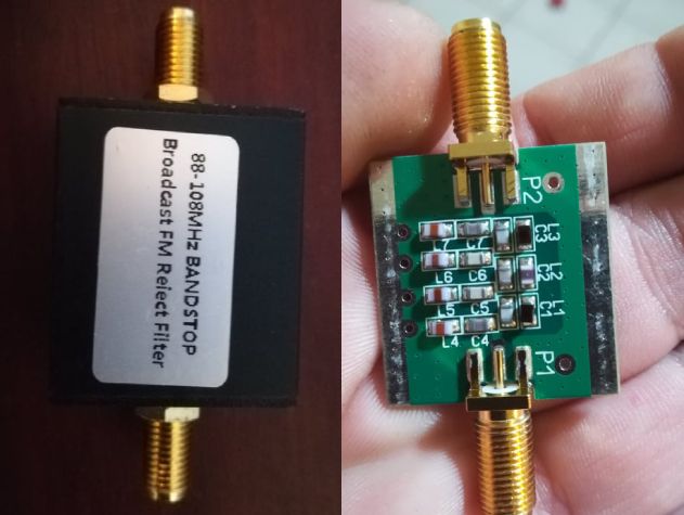

For this system I used a FM bandstop filter, a SPF5189Z LNA and I created a bandpass filter.The signal is transmitted from the antenna via the transmission line to the FM bandstop filter where noise from radio stations is eliminated. The signal is then transmitted to the bandpass filter for further isolation and finally the filtered signal is amplified for ~25 dB by the LNA, which is connected to the SDR.
I purchased the bandstop filter from AliExpress, here's the schematic in case you want to built it yourself.
To create the bandpass filter, I used two 2.7 pF Capacitors in parallel (total capacitance of 5.4 pF) connected in series with a 248 nF inductor (I used normal coil of 0.5 mm diammeter to create the inductor with the help of this calculator). I soldered everything to a PCB and used corresponding RF connectors (SMA for PCB).

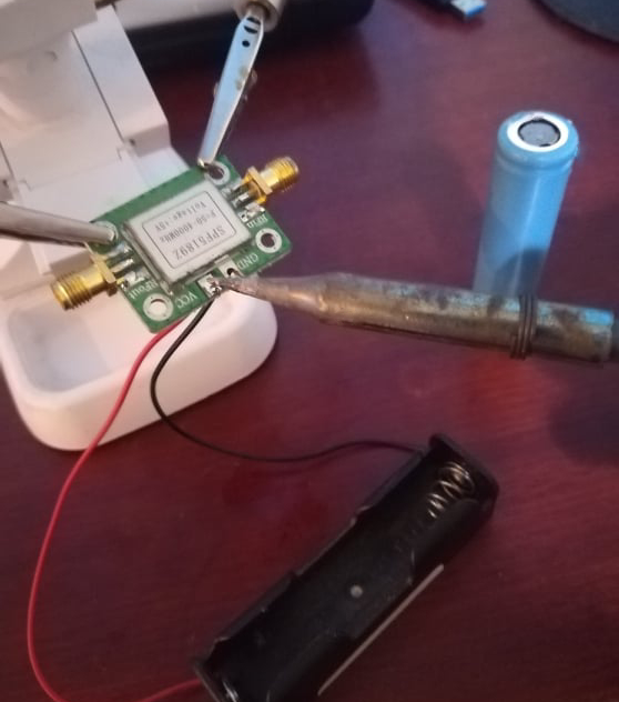

I used a 18650 battery case and I soldered it to the PCB of the SPF5189Z LNA.
Finally, I connected the system to the SDR.
