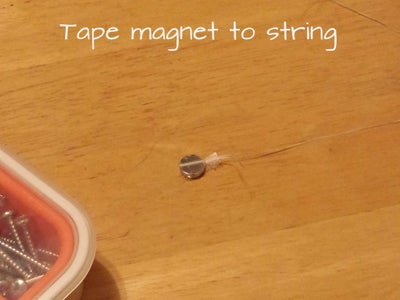

Tape the magnet to the end of the string.

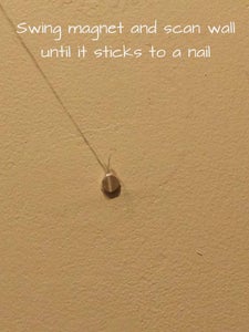

- Hold the stud finder like a pendulum, and swing it back and forth along the wall. You'll want it to swing so it covers an arc that is at least a foot or so wide.
- Move your hand slowly up the wall so the magnet scans a path along the wall. The magnet will stick to any nailheads in the wall. These nailheads are the ones used to hold the drywall or sheetrock to the studs.

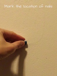

- Once you find a nail, mark it with a pencil or with another small magnet. It helps to re-center your sweep path over the magnet for the highest probability of finding others.

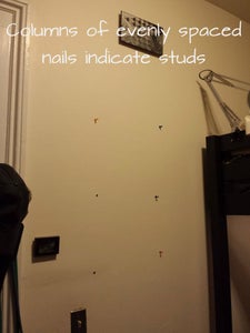

- When you find a vertical column of 2-3 or more nailheads, you can know for sure that you've found a stud. If you find isolated nails that aren't in a column of evenly spaced nails, you probably found a random mis-placed nail that got painted over.
Note: according to building codes and conventions, studs are spaced 16" apart in the United States. If you find one column of nails along a stud, and you need another one, start your next search path some whole number multiple of 16" over.
