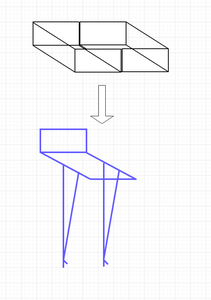

There are heavy-duty flat front baskets (sometimes called "porteur" or "pizza" racks) for bicycles. They may be hard to find and they tend to cost hundreds of dollars. Here is a way to build a medium-duty flat front rack for less than half the cost. Even cheaper if you have some of these parts already gathering dust in your basket(s) of spare parts. ^_^

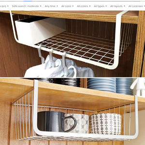

  1. two under-shelf storage baskets for a kitchen cabinet, each approximately 39cm x 26cm <<<=== obtain as cheaply as possible, try scrounging in discount household stores

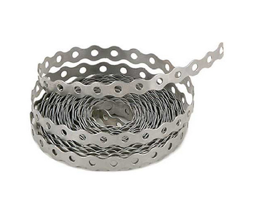

  4. malleable metal strapping (general hardware)

Step 1: Install the Front Touring Rack
A) Do a standard installation of the front touring rack if your front fork has mount points for metric bolts. The result will be similar to the example image.

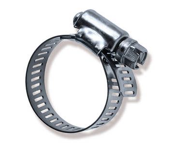

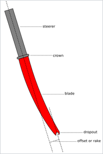

B) If your bicycle's front fork does not have mount points — as is likely the case of a bicycle with front suspension — you will need to use the hose clamps to secure the "legs" of the front touring rack. Attach one hose clamp to each "blade" of the front fork. Optional: Protect the fork blades by wrapping them in pieces of used inner tube.
Slip the "feet" of the front fork into the clamps. Each "foot" may have two "toes", as in the sample image. Slip the longest toe through the clamp. Keep the shorter toe above the clamp, extended forward. Be sure to tighten the clamps!

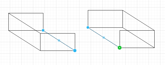

Step 2: Clamp the Two Under-Shelf Racks Together

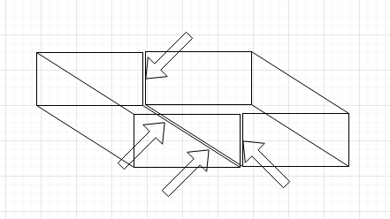

Think of each under-shelf basket as half of the porteur basket that you are building. Clamp the two under-shelf baskets together, upright and opening-to-opening, using several two-hole straps and 5mm bolts.
The arrows suggest where to use some two-hole straps.
Now you have one large basket!

Use more two-hole straps with the 5mm bolts to clamp the combined basket to the top of the front touring rack. Use sections of malleable metal strapping with 5mm bolts where necessary.
