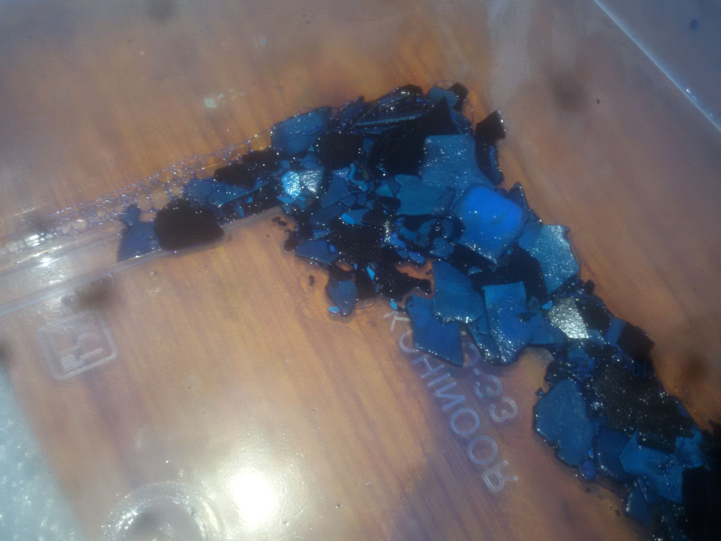

The activator solution is prepared as follows.
1. Take 140ml of water and dissolve 30g of copper sulfate in it. Stir until all copper sulfate is dissolved. At this point solution will get light blue color.
2. Pour into solution 22g of calcium hypophosphite and carefully stir it for 3-4 minutes. Once you pour calcium hypophosphite into solution, there will appear sediment which change solution color to white-blue. The sediment consists mostly of gypsum (calcium phosphate). Note that there is quite high amounts of sediment, so use at least 0.5 liter cans for preparing solution.
3. Filter the solution through funnel with filter paper placed into it. Again, use large funnel. Also, at the end speed of the filtering might be quite slow, so be patient. The solution should have light blue (perhaps a little dull) color.
4. Pour through the sediment another 100ml of water.
5. Remove funnel and add 40ml of 25% ammonium hydroxide. WARNING! This reagent stink! So, while you'll be doing this, try to keep nose as far from the solution as possible. Once ammonium hydroxide is dissolved in the solution, it stinks much less, so activation solution is usable indoor, although it still stink so the container with the solution should not be left open for long time. The solution quickly thicken for some time and you'll see white flakes, but they quite quickly disappear and solution obtains deep blue color. You may speedup this process by stirring the solution.
6. Add about 5-6ml of liquid soap and stir for few seconds.
7. Add about 8-10g of calcium hypophosphite. Part of it will dissolve, but part of it will remain as a sediment in the solution. Stir solution for few seconds to speedup process.
Solution is ready. It is quite stable and can be stored for a long time without loosing its properties. Use tightly closed container and store it in dry place, away from direct sunlight and out of reach of children and pets. Since solution contains copper compounds, it might be toxic if you'll drink it, so it is not recommended to do so :)
Solution requires maintenance, especially if used intensively. Maintenance is quite simple - just check from time to time if there is still calcium hypophosphite sediment at the bottom of the container where solution is stored and if necessary add few grams of calcium hypophosphite.
Once you prepared the solution you're ready for the next step.

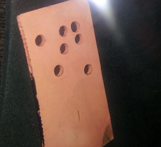

Step 2: Preparing Copper Laminate
Preparation of the laminate is very important step, it actually defines quality of holes after plating, so take special attention to this step.
1. Cut laminate to size slightly larger than board size. One edge usually is used for the fixing board during electroplating, so at one side make larger margin.
2. Drill the board. All drills must be of exact necessary size, there will be no chance to drill hole of larger diameter without destroying copper in hole once hole is plated. Use tungsten carbide drill bits to get clean holes suitable for the plating.
3. Carefully inspect all holes against the light source and make sure there are no copper chips left in the holes.
4. Carefully sand copper surface with the flint paper of largest available number (i.e. with the smallest size of abrasive particles) and make sure that there are no copper borders around holes, especially at the opposite side.
5. Carefully wash the board using dishwashing detergent with soft abrasive, for example Cif or something like that.
6. Finally carefully rinse the board in water.
7. Inspect holes again and make sure they are clean.
The board is ready for the next step.
Image shows prepared board right before activation.
